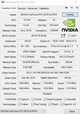

Please, also download and run GPU-Z:
https://www.techpowerup.com/gpuz/
And share a screenshot from the Graphics Card tab, for all the available Nvidia GPUs, thanks: ciao,

Hi beppe,
Thanks for the response.
Here is the log report you asked for and the screenshot.
