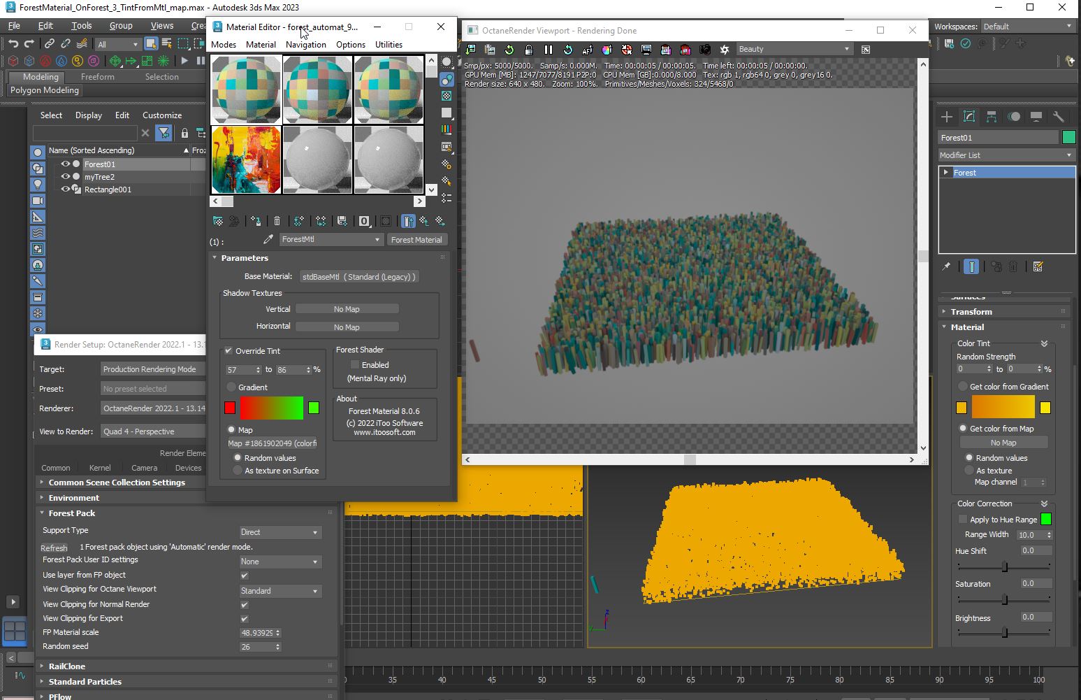

Forest Material:
This allows to add a random tint to any material placed in the Base Material slot.
This works by inserting an Octane Composite Texture in the material main color node.
The Base material can be an Octane material, or any material that support 'on the fly' conversion.
Limitations:
Shadow Textures and Forest Shader are not supported.
Forest Color:
This allow to set a random color, with additional random tint .
Up to 10 map or colors can be chosen randomly.
The tint can be selected from a gradient or a map.
Limitations:
Variation slider from Item to Element is not supported.
Apply Color Correction is not supported.
Both Forest Material and Forest Color can be used on a Forest pack object,
and will use the tint specified in the Material rollup, if 'Override Tint' is disabled in the FP material / color, and if
the Random Strength is not set to 0,0.

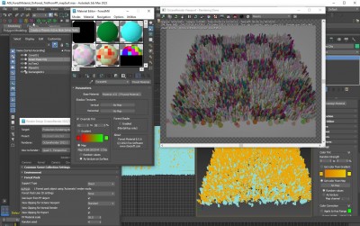

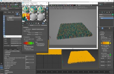

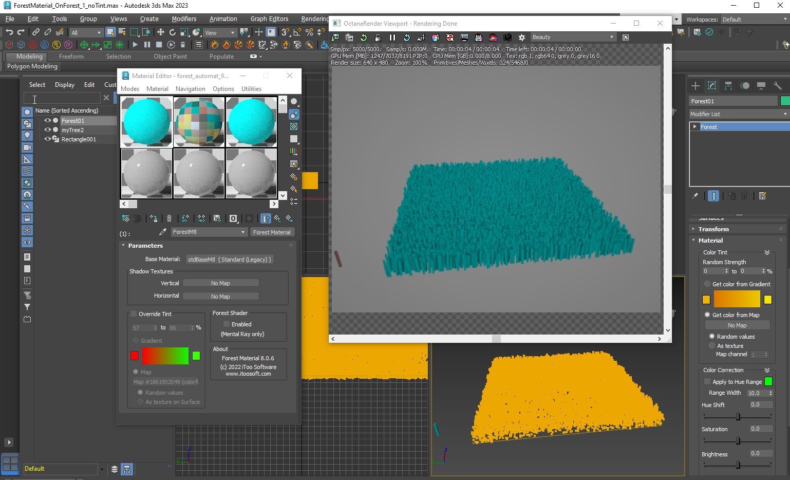

A01_ForestMaterial_OnForest_noTint.max
No tint is used, the final material is just the Base Material. (some bright blue)

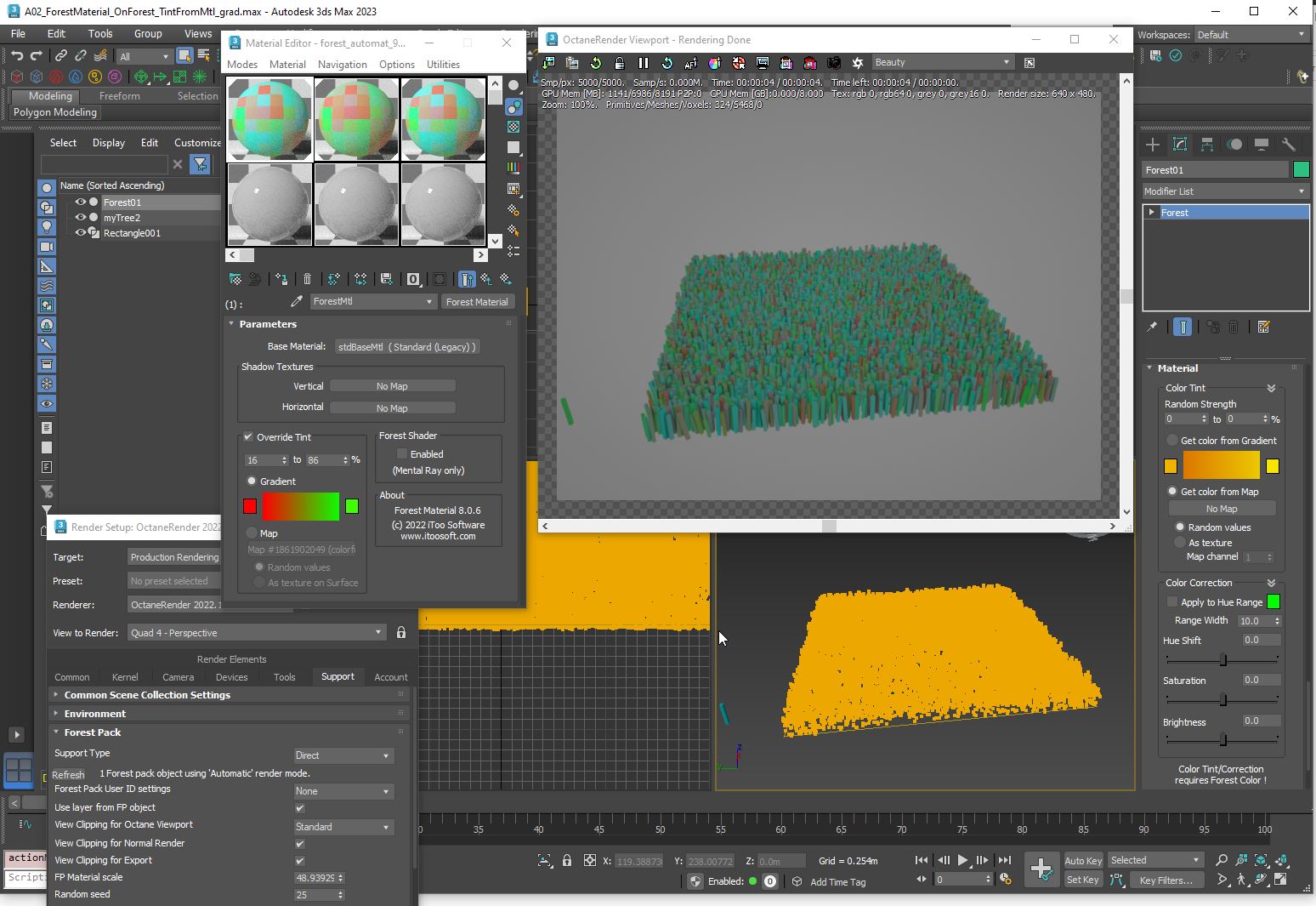

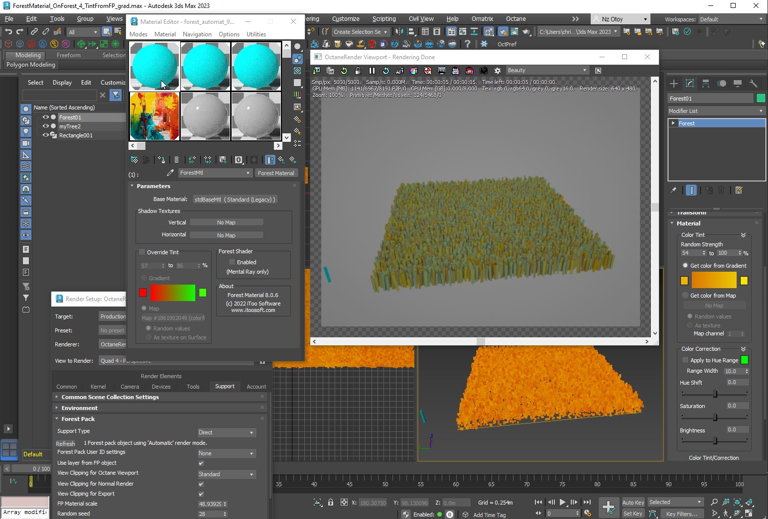

A02_ForestMaterial_OnForest_TintFromMtl_grad.max
Override Tint is used in Forest Material.
The bright blue of previous sample is tinted with the red-green gradient.
Use the min and max percent values to set a strength range.
Use the Render settings / Support / Forest Pack / Random seed value to change the random tint
A03_ForestMaterial_OnForest_TintFromMtl_map.max
Override Tint is used in Forest Material, with colors picked from a bitmap.
The bright blue of first sample is tinted with the random colors.

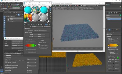

A04_ForestMaterial_OnForest_TintFromFP_grad.max
The tint is set from the Forest object.
(Forest pack 'Material' section has Random Strength values bigger than 0, and the Forest material do not use Override Tint)
A05_ForestMaterial_OnForest_TintFromFP_map.max
The Forest Object tint uses a map, in Random values mode. Here we used an Octane Flake texture.
A06_ForestMaterial_OnForest_TintFromFP_mapSurf.max
The Forest Object tint uses a map, in As Texture on Surface mode. Here we used an Octane Checks texture.
Use the Render settings / Support / Forest Pack / FP Material scale to adjust the size of the Checks texture.

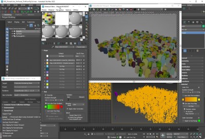

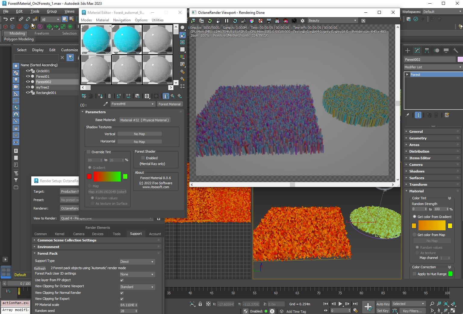

B01_ForestMaterial_On2Forests.max
2 Forest Pack objects use the same Forest Material, but enable a Color Tint with different colors.

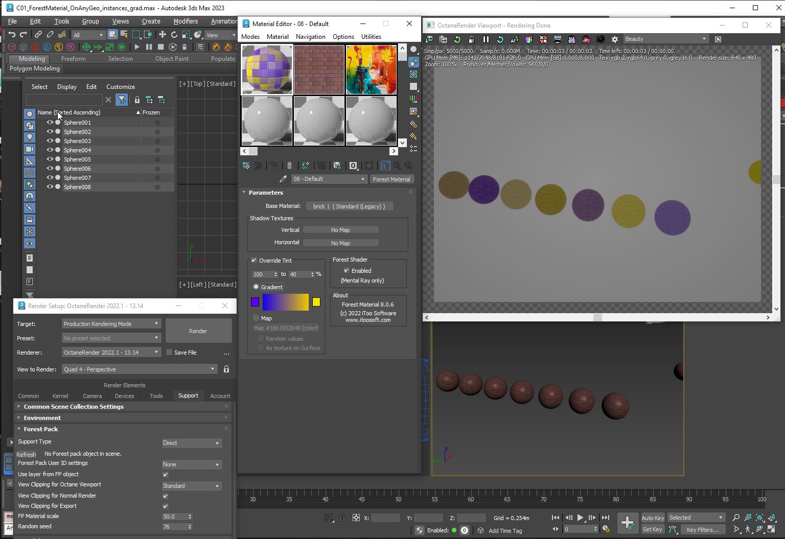

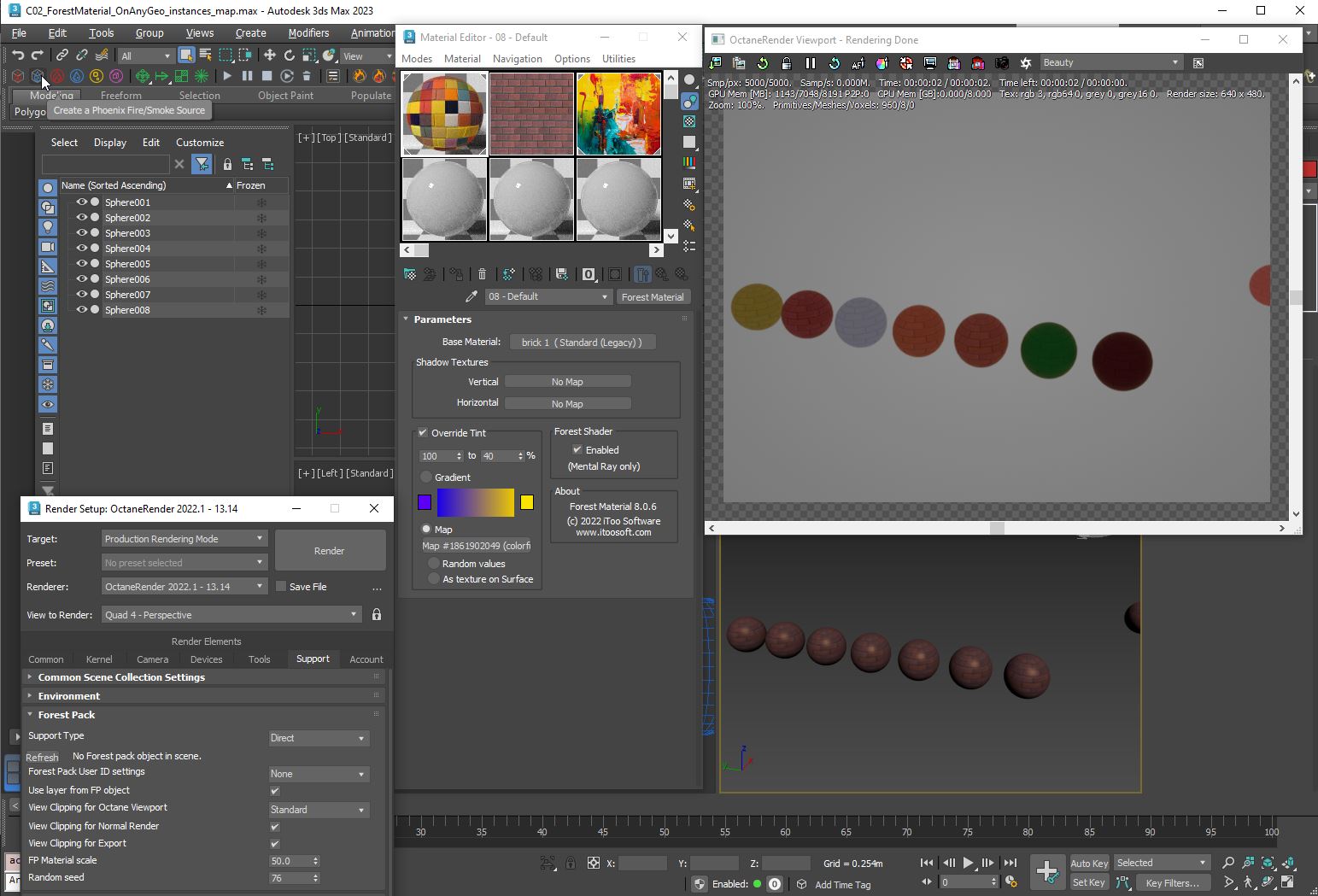

C01_ForestMaterial_OnAnyGeo_instances_grad.max
Forest Material can be applied to any geometry.
When using multiple instances, each instance will have a different 'randomness'
C02_ForestMaterial_OnAnyGeo_instances_map.max
The map mode can also be used for tint.

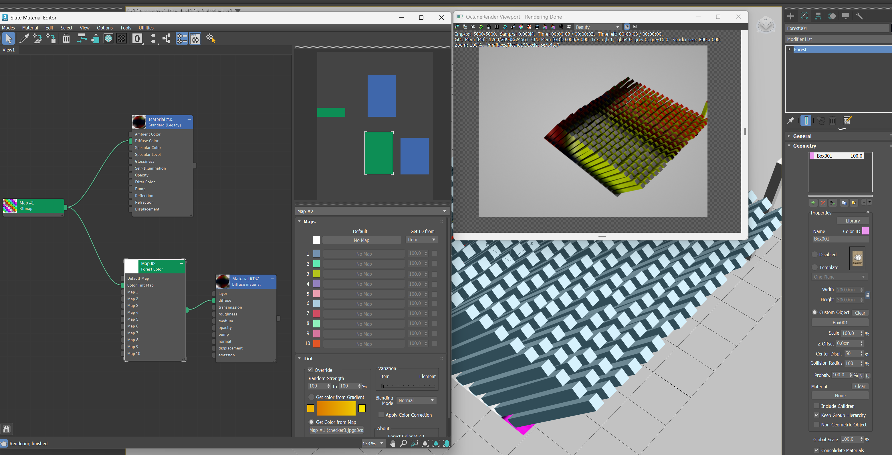

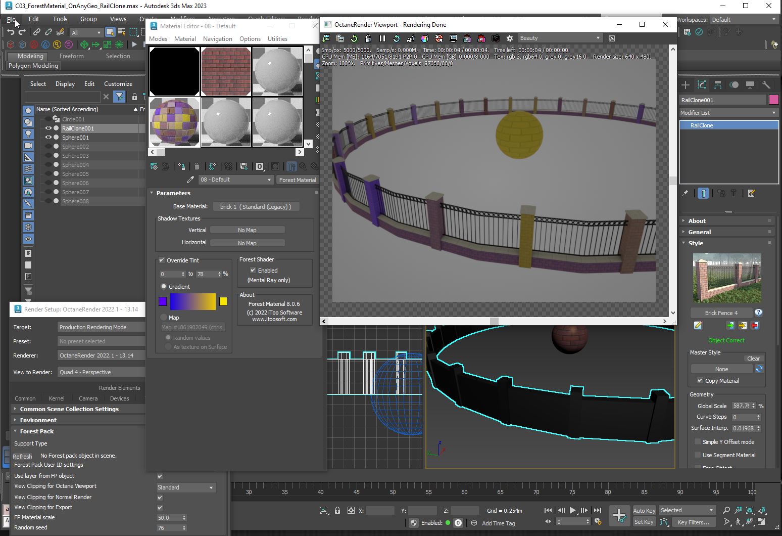

C03_ForestMaterial_OnAnyGeo_RailClone.max
Any scattering tool that generate multiple instances should work with Forest Material.
Here one of the material of the railclone object has been set as Forest Material.

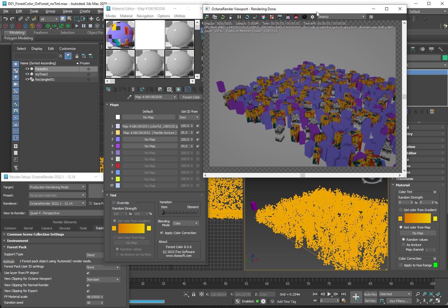

D01_ForestColor_OnForest_noTint.max
The basic usage of Forest Color is to randomly select one color / map per instance.
Here, a Standard material use a Standard Bitmap, an Octane Marble texture, and 2 colors.
The percentage of chance to be selected can be adjusted for each of the 10 slots.

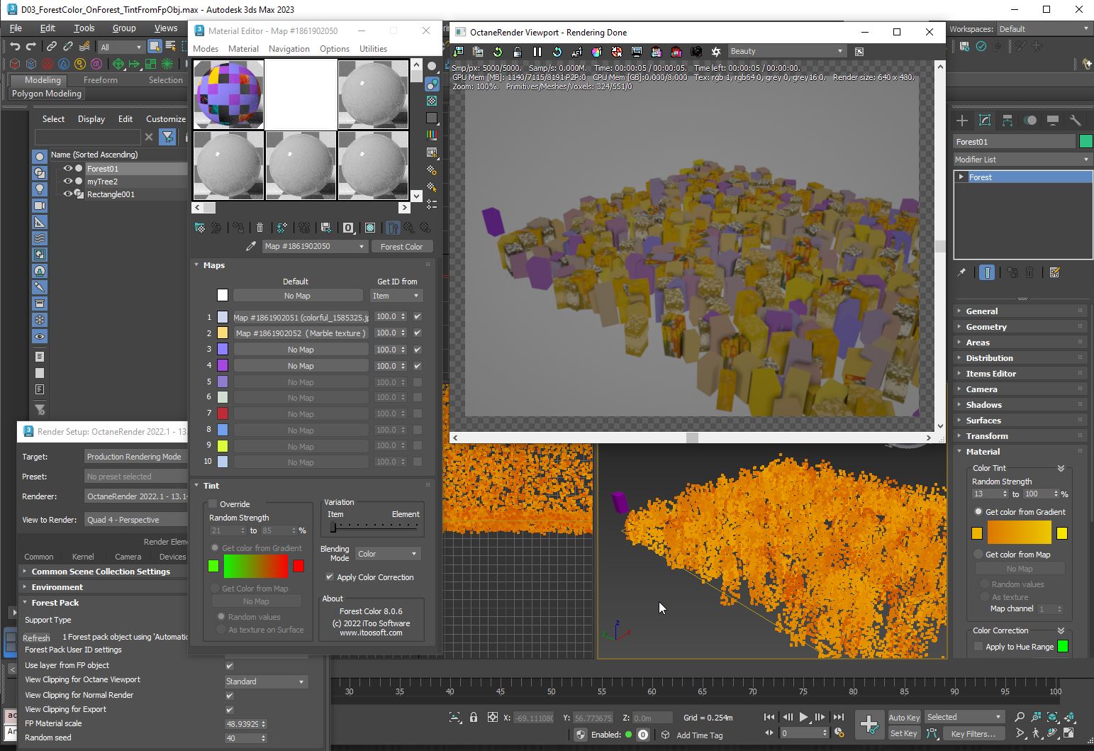

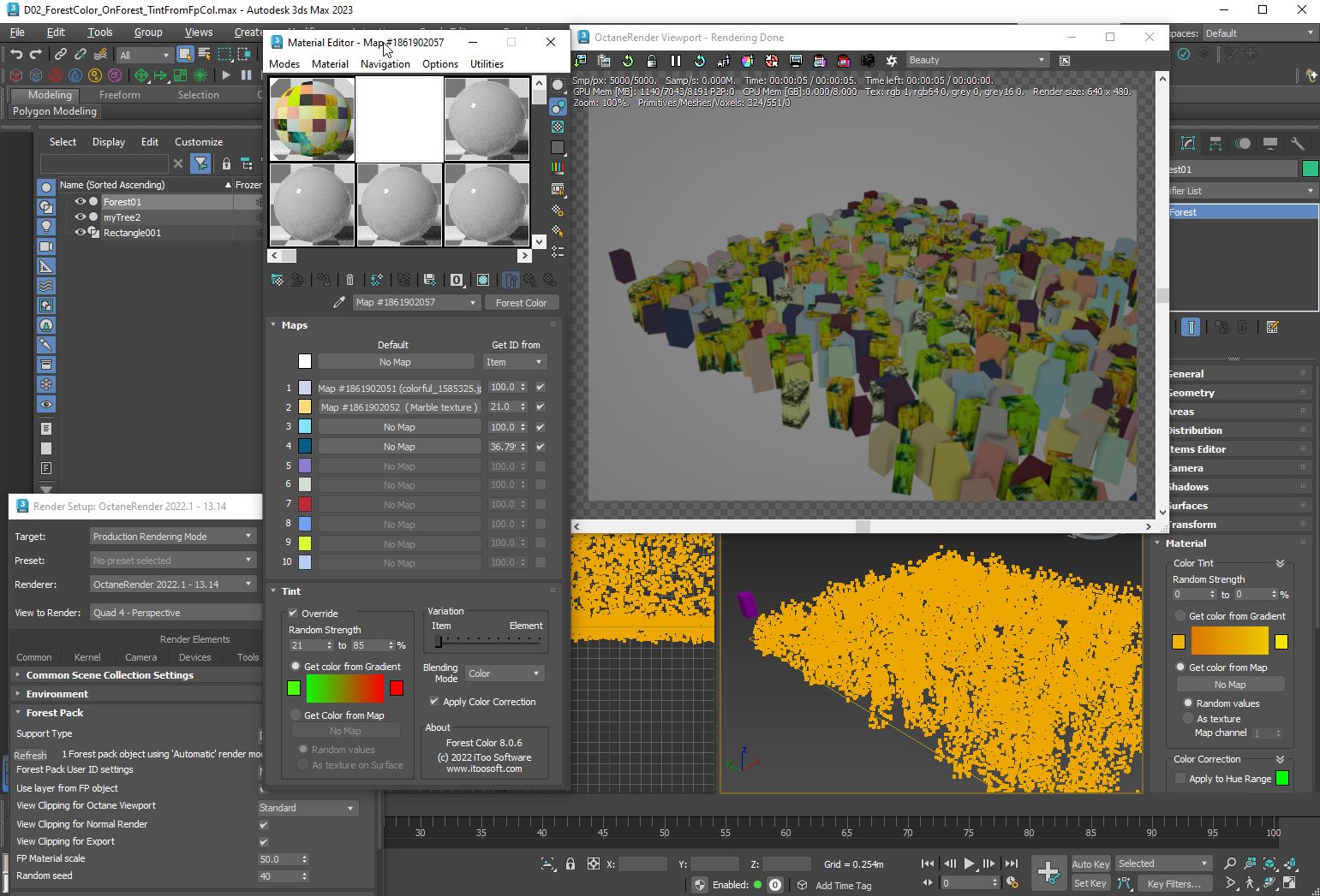

D02_ForestColor_OnForest_TintFromFpCol.max
The Forest Color tint is enabled.
D03_ForestColor_OnForest_TintFromFpObj.max
The Tint is set in the Forest Object.

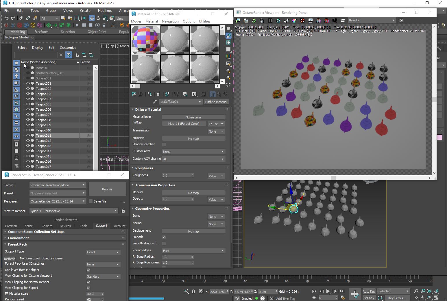

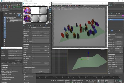

E01_ForestColor_OnAnyGeo_instances.max
Octane material can use Forest Color in any texture slot.
When applied to standard instanced geometry, a random color / texture from the 10 slots will be used, with optional Tint options.

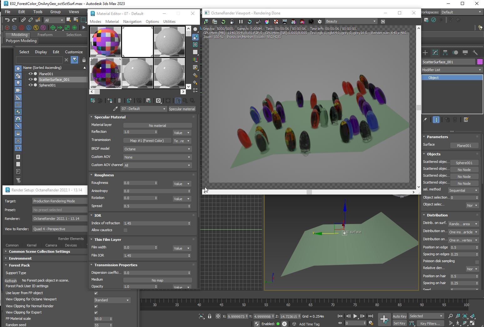

E02_ForestColor_OnAnyGeo_octSctSurf.max
Geometry instances from an Octane Scatter Surface can also use Forest Color.
Here, an Octane Specular material use a Forest Color in the Transmission slot.

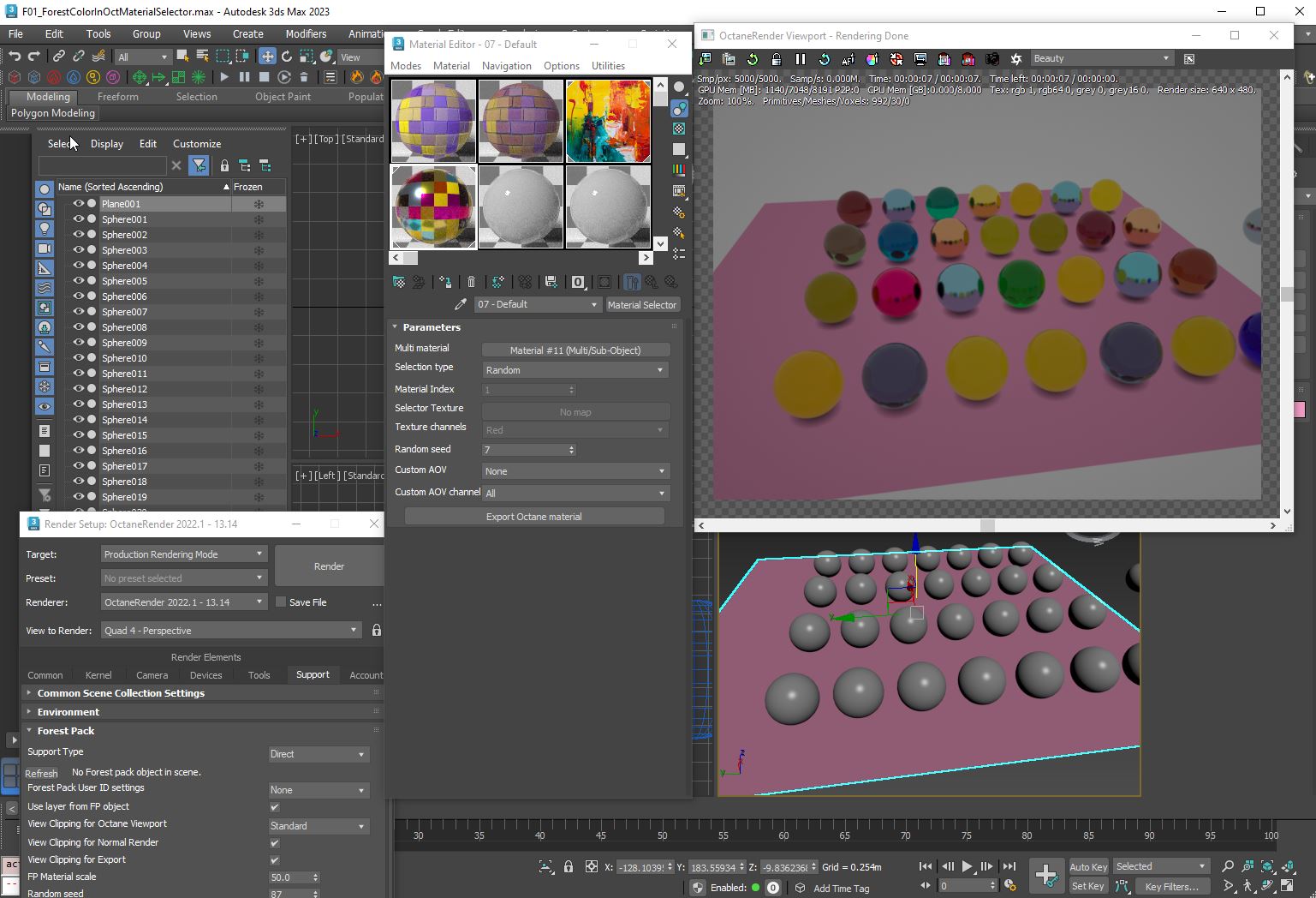

F01_ForestColorInOctMaterialSelector.max
For additional randomness, the Octane Material Selector will assign materials randomly to multiple instances.
Each of those material can use a different Forest Color map..

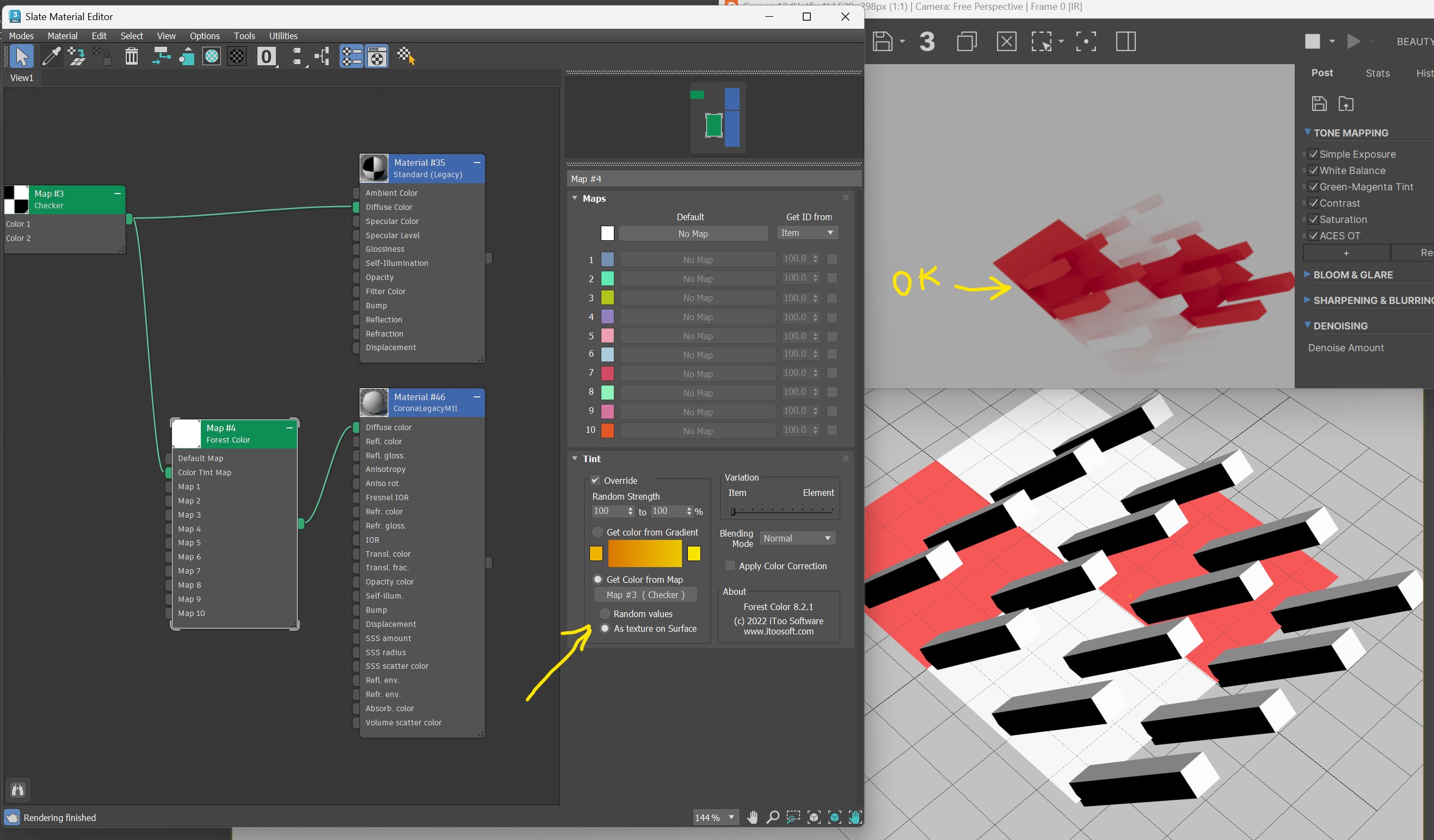

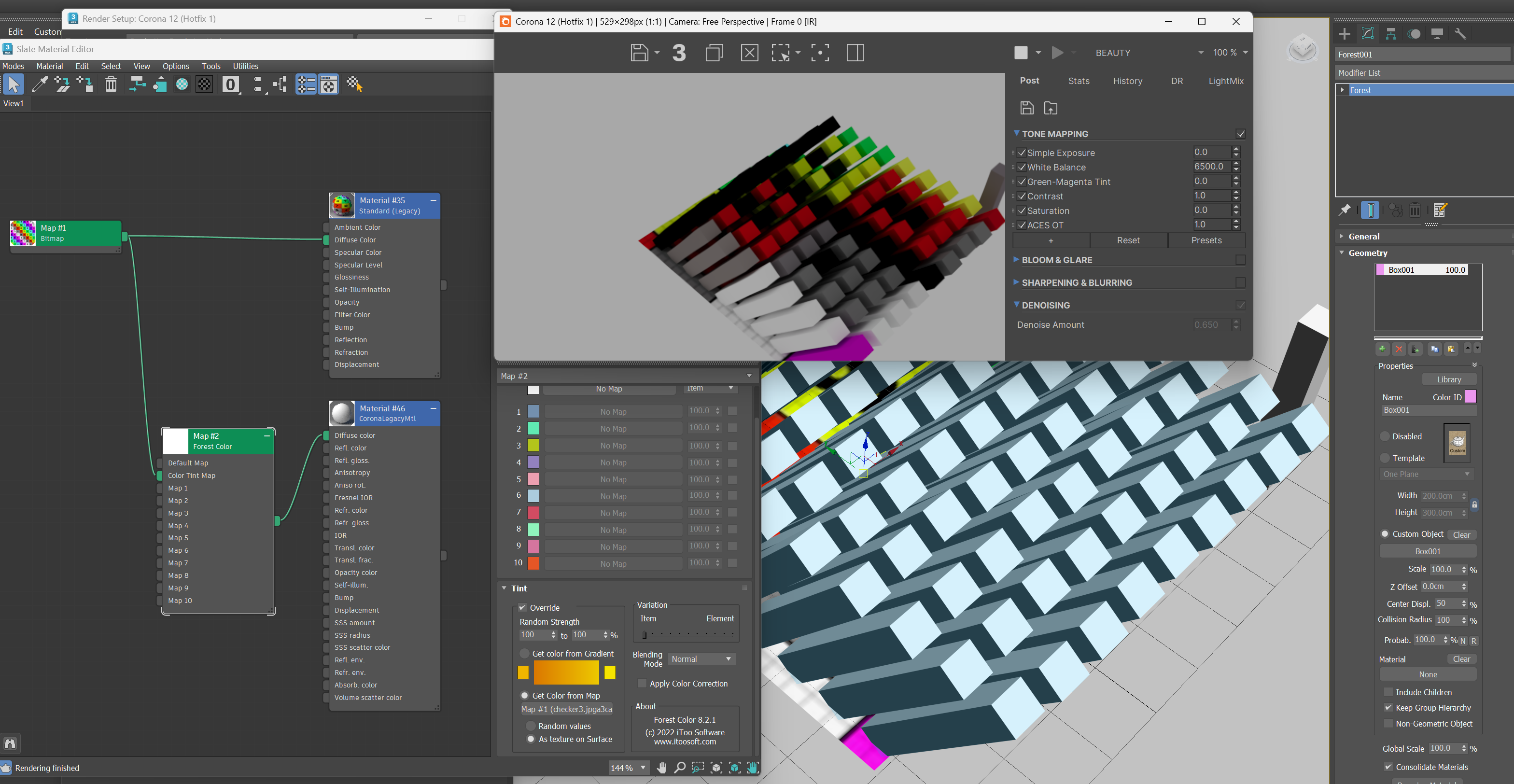

Hello.
How to replicate this effect in Octane and ForestPack? In the Corona Renderer, objects inherit the color from surface. This does not work in octane. Any ideas how to fix this?
Octane render
Octane render
Сorona render
Сorona render

ramone163 wrote:Hello.
Hi ramone163,
Could you please post a sample ?
And could you explain what is the 'surface' you are referring to ?

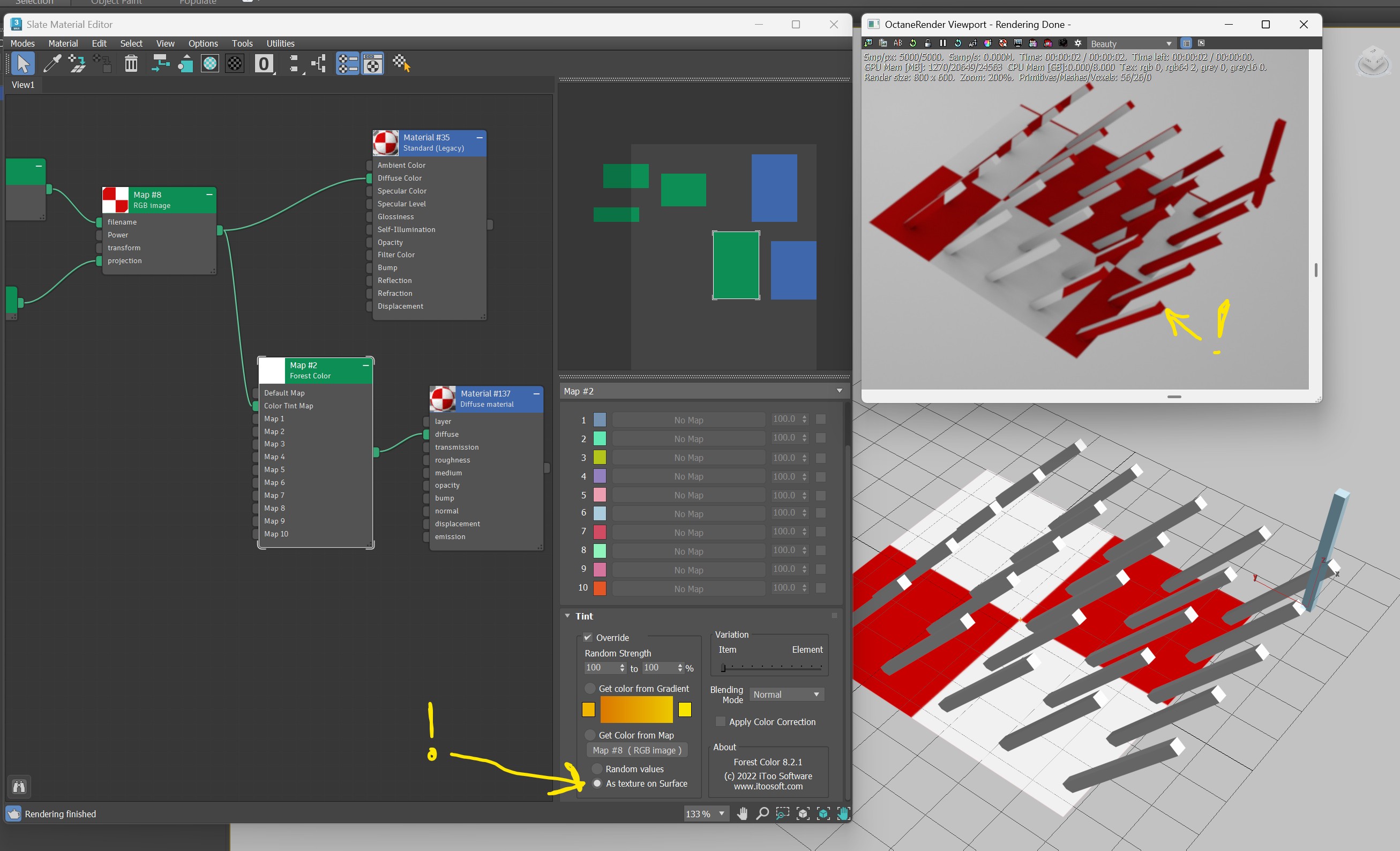

neonZorglub, please check my ZIP file.
I am talking about this "As texture on Surface" option in Forest Color map.
I need to color objects with the color of the surface pixel the forestpack object is on.
In corona renderer everything works as it should.
I used this tutorial as a basis:
https://www.youtube.com/watch?v=R-lI8lVUX-I
Corona render
Corona render
Octane render.
Hi ramone163,
Thank you for the sample and explanations.

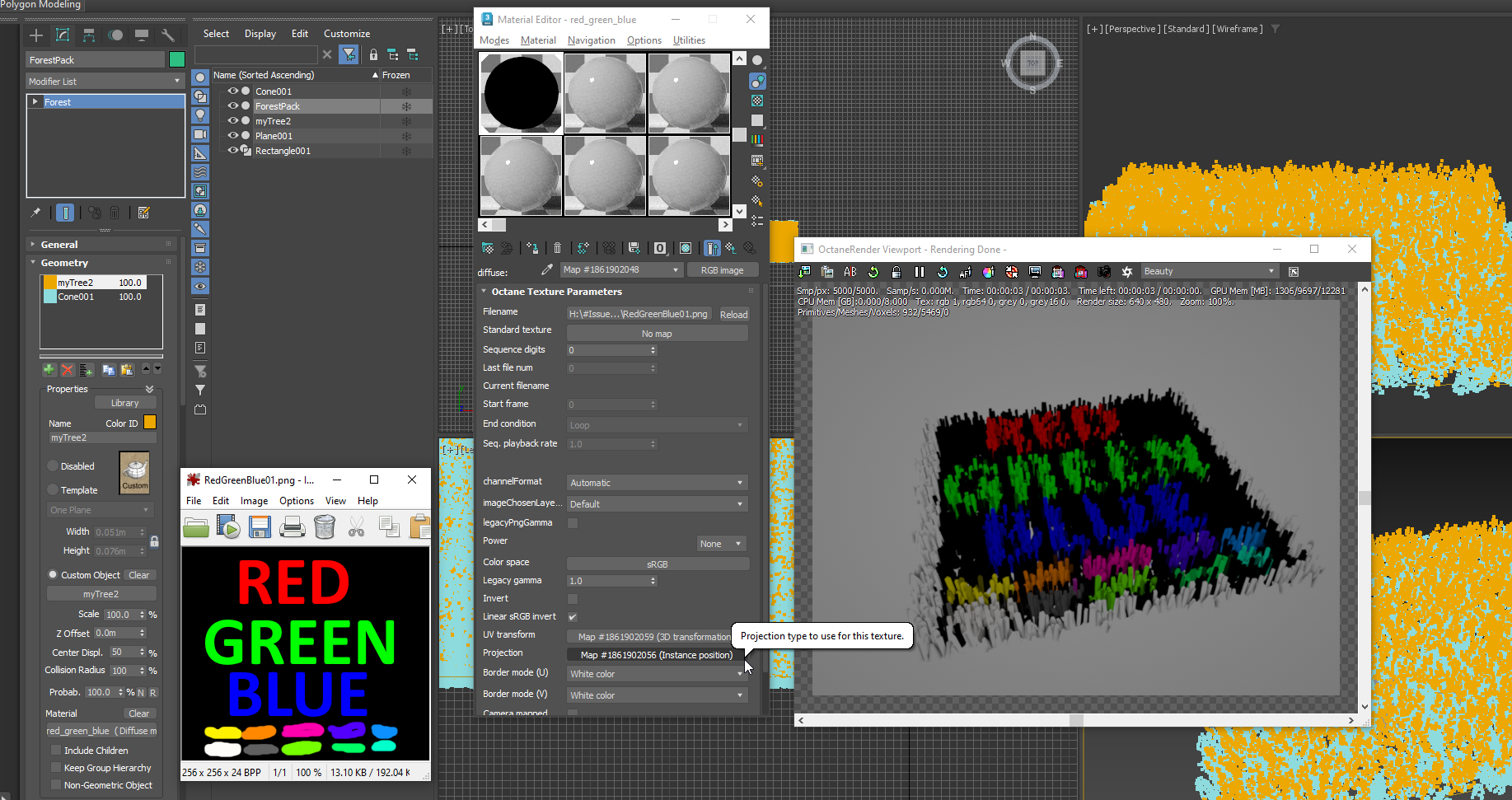

That's right, the current implementation of the FP color texture with the Tint map is not correct.
it's using a box transform that 'project' a color from the map vertically to the FP instance objects.. so it can't work well in you case..

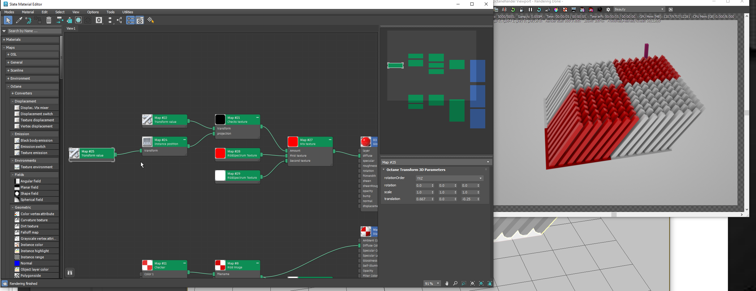

The best alternative I found is to use the Octane 'Instance Position' projection with one of the Octane texture map.
We can get the same effect as FP, but the scale and translation need to be adjusted by hand ..
Here are some samples:
InstanceColorFromMap.zip
(244.15 KiB) Downloaded 540 times
Both the transform of the texture and the transform of the 'instance position' can be used to adjust the effect.
I might try to add a custom OSL texture that would apply those scale/transform automatically in the future..
