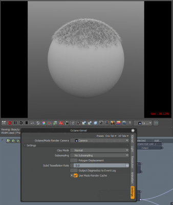

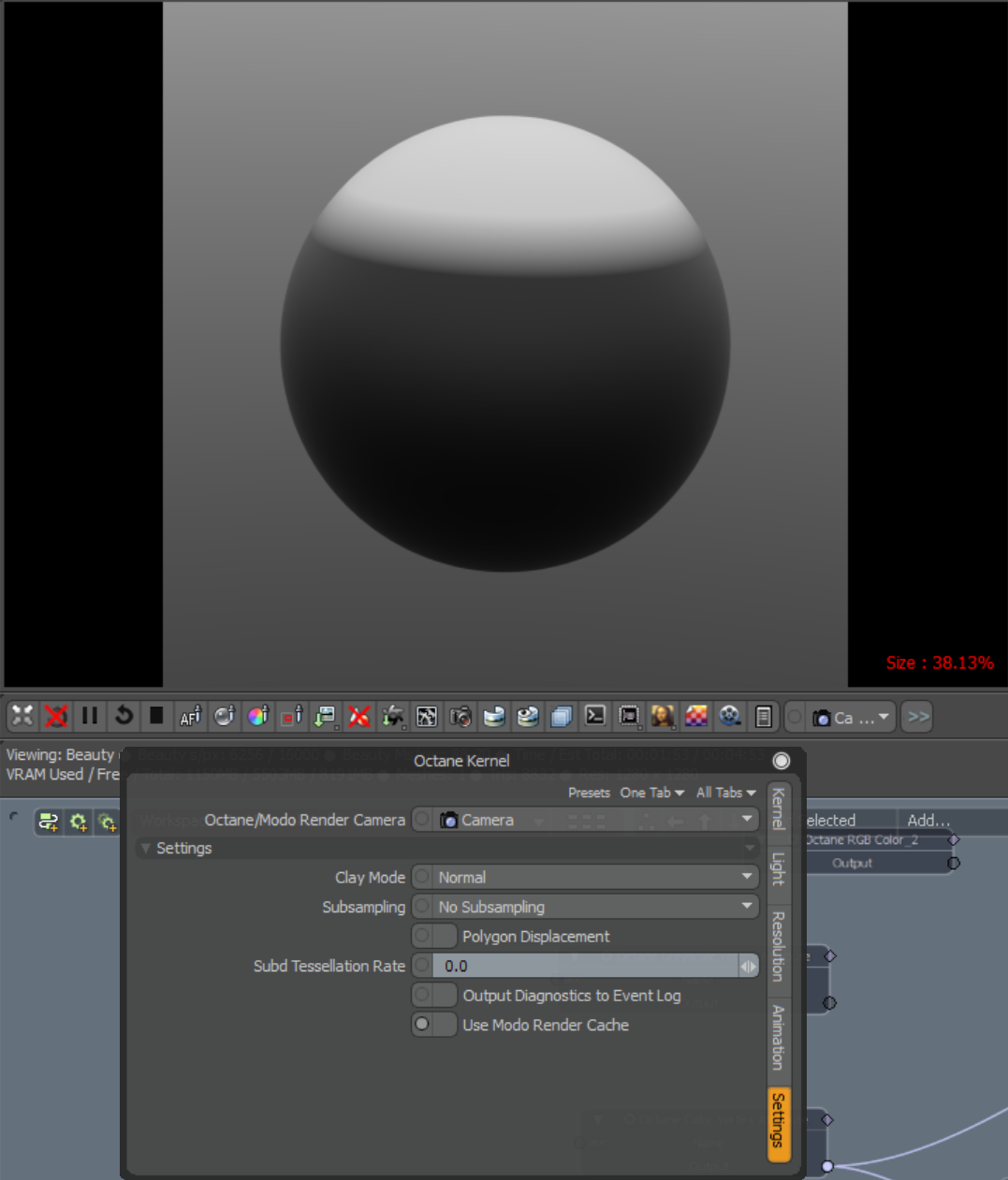

Hello all.
It looks like if "Use Modo Render Cache is On" (meaning you can nicely render fur) - you cannot use weight maps as a Greyscale Vertex Attribute.
Can someone confirm?
funk
Posts: 1207
Joined: Mon Feb 07, 2011 1:24 pm
Location: Australia
Confirmed, although I don't know what the technical reasons for this are.

So here's the scene file.
Octane_Vmaps_RenderCacheIssue.zip
(21.24 KiB) Downloaded 139 times
Simply turn on or off "use modo render cache".
Preffered is on as it allows to use fur but it is also preffered to use vmaps (for ad hoc quick material masks instead of using images).

face_off
Posts: 15813
Location: Adelaide, Australia
Mr_Uzu wrote:Ok, thank you Paul, hopefully it will come something good from it. :)
I have heard back from Foundry on this issue, and their response was that Vertex Maps are /not/ supported in the current version of the Render Cache SDK, but it is something they will look at implementing in the future.
