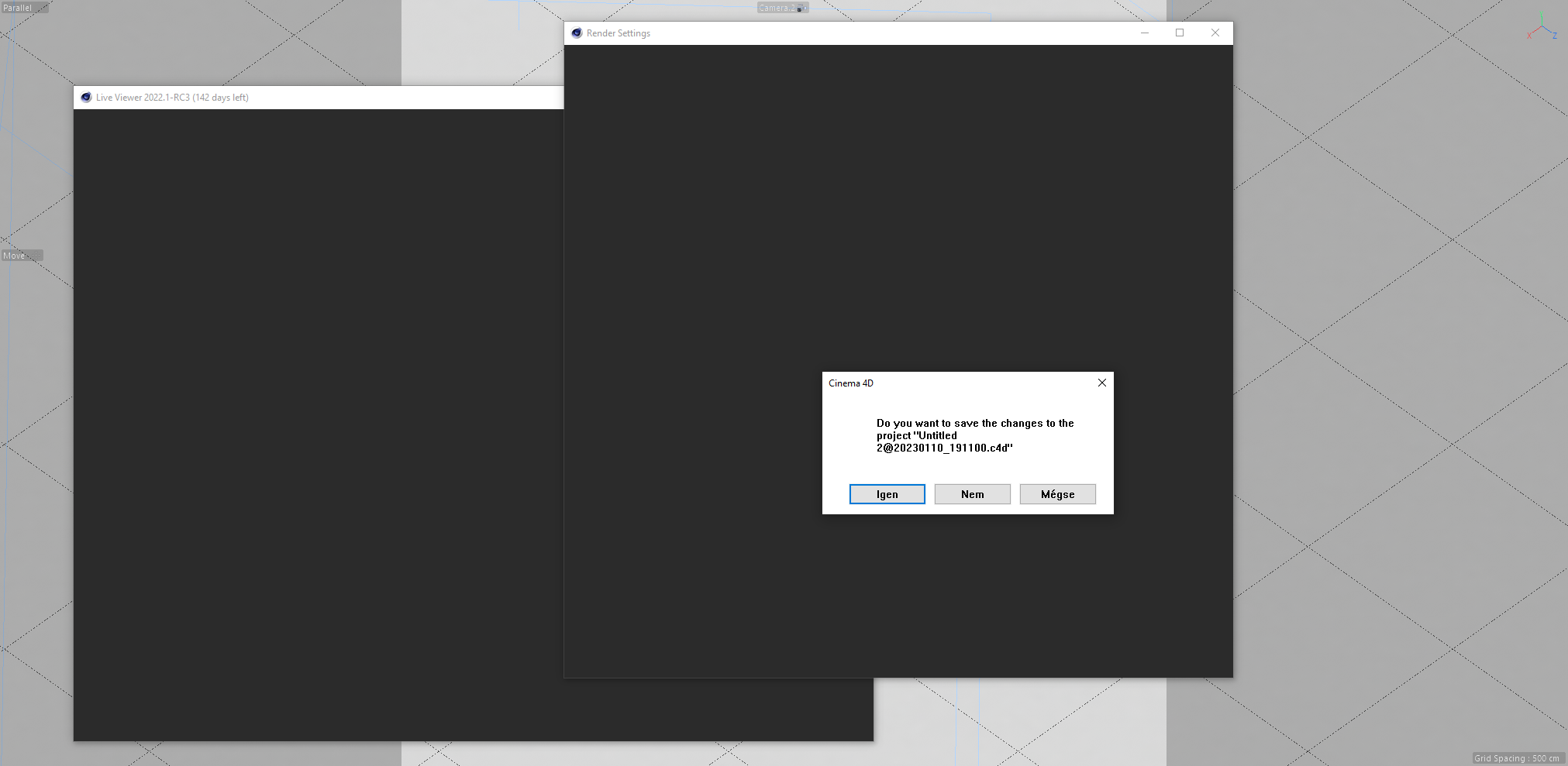

weird octane crash randomly happening while live viewer is running, its like octane plugin stop working and destroys the whole ui of c4d (look the printscreen)

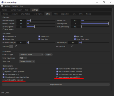

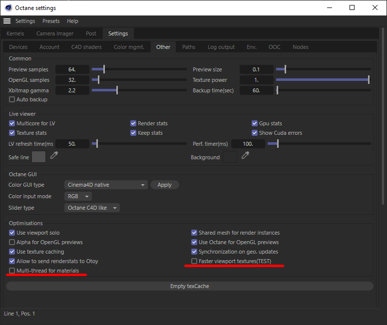

- mohari.mate
- Posts: 11
- Joined: Tue Mar 01, 2016 4:16 pm
Which one is related here? I don't suppose "Faster viewport textures" can cause this. Also "Multi-thread for materials" is used for material creation on you send the scene, not else of this.mohari.mate wrote:interestingly i turned these off and the problem seems resolved
