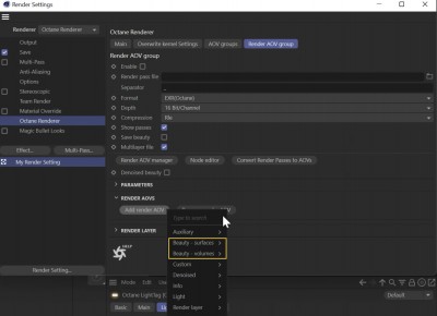

I've tried a lot of different things, but deep down I'd like to know if anyone knows a way to render the "normal" scene without volumes, and another AOV with only isolated volumes.
I've already managed to isolate only the volumes with Volume AOV, but I can't isolate just the scene without the volumes, whenever I combine a group of lights with the aov it never gives me the same result as the scene without the fog.

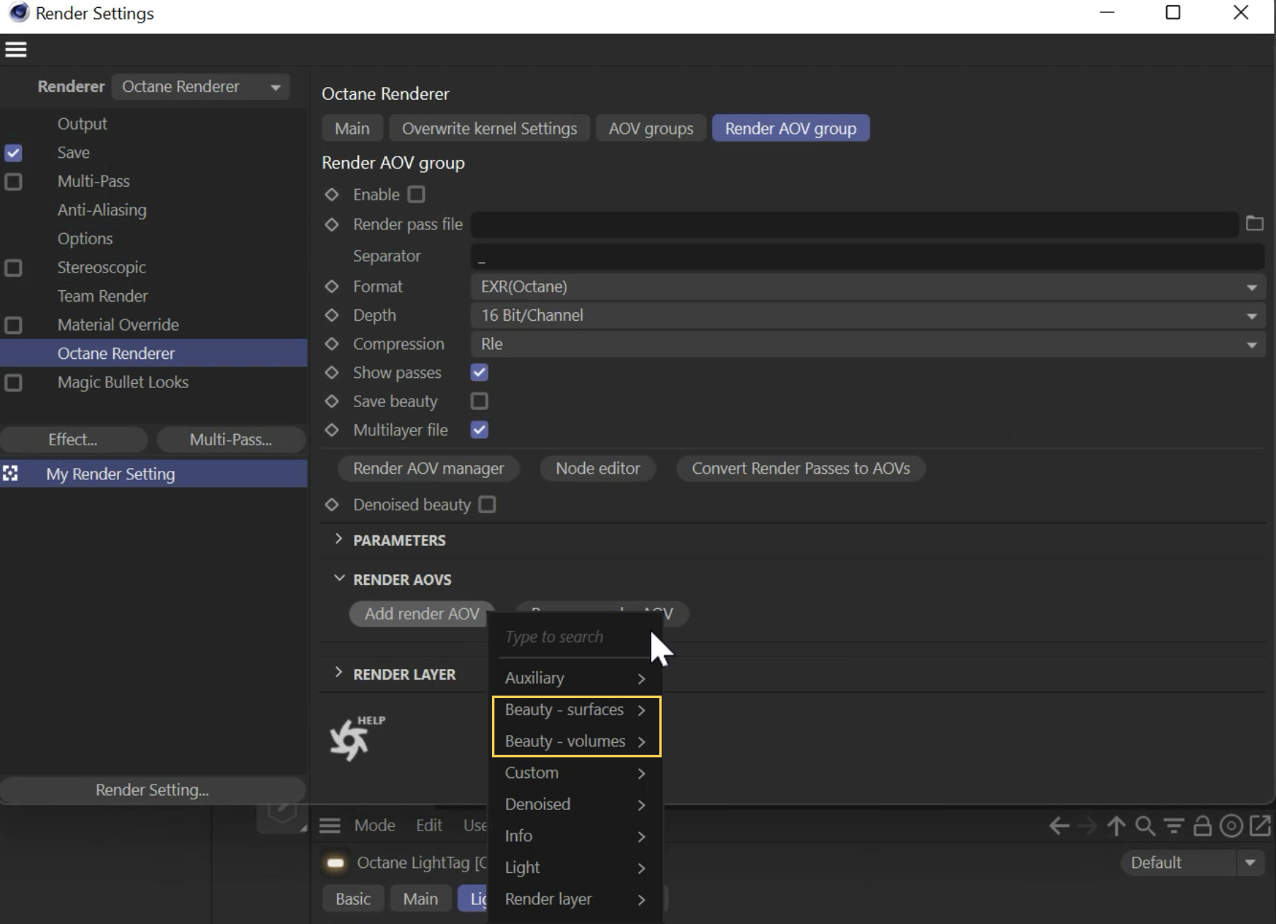

in short, only Beauty passes can be combined, all the other AOV types cannot be mixed with Volume passes:
