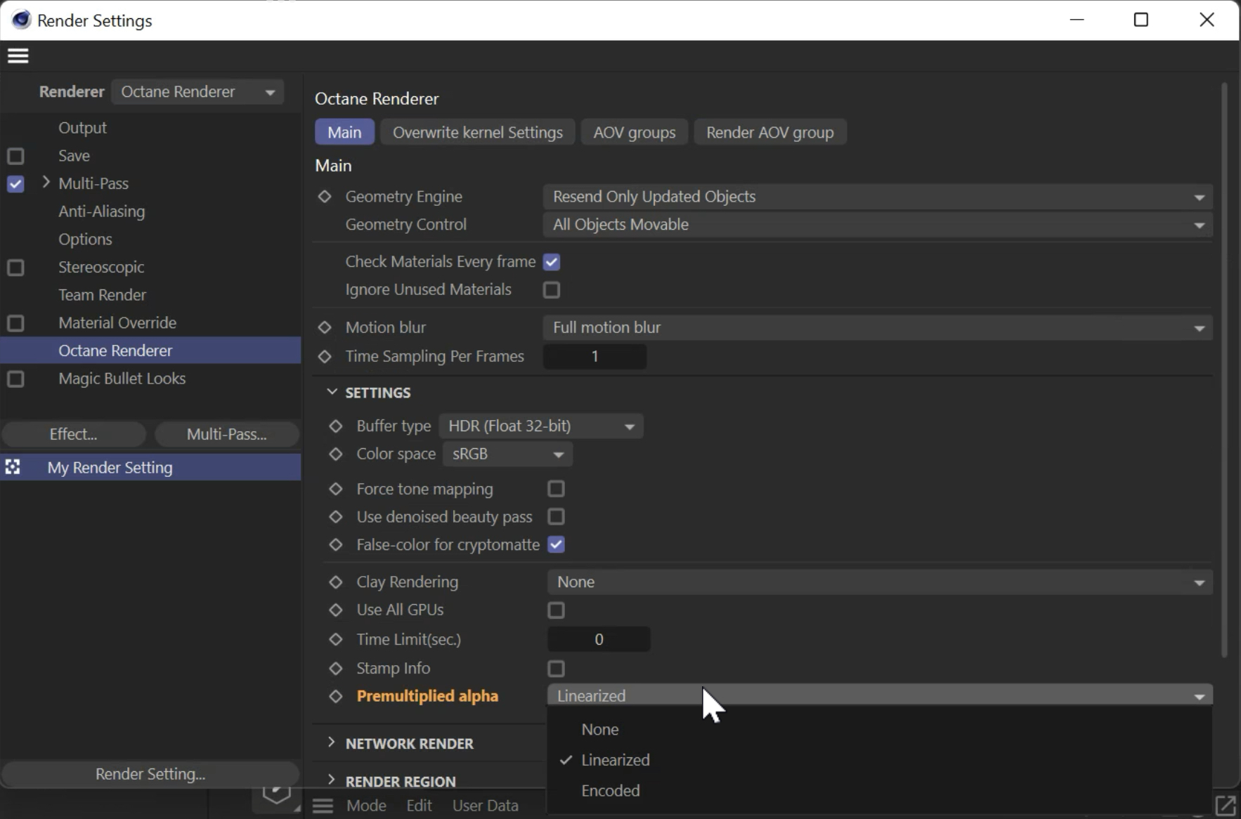

Posts: 10326
the Premultiplied alpha option was part of the Camera Imager node in the past, now it has been moved to Render settings/OctaneRender/Main tab:
ciao,
