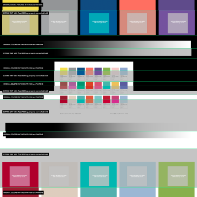

So i finally managed to get somewhat similar output in the octane viewport and AE, still not 100% the same but it is close.
However this is a test I did with flat lightning and pure diffuse material and as a texture i got some pantone color samples and did a separate color check in PS and matched the colors with 100% accuracy.
So the RGB and hashtag values of the colors in the image are correct.
However when I do all the necessary conversion in AE, and it is indeed matching the octane viewport somewhat, the whple rendered image is way off in saturation and brightness check the attached image.
More strange is when I put diffuse color values exactly like provided RGB values in Octane RGB spectrum texture they are looking completely washed out.
Let me know what am I missing.

Braca wrote:So i finally managed to get somewhat similar output in the octane viewport and AE, still not 100% the same but it is close.
Hi Braca, could you upload a copy of the test scene you are using, ideally exported to ORBX format? That would be very helpful to figure out what's going on.
Also, when you say "properly converted in AE", exactly what conversion are you doing? There are a few different things that could potentially be considered "proper".

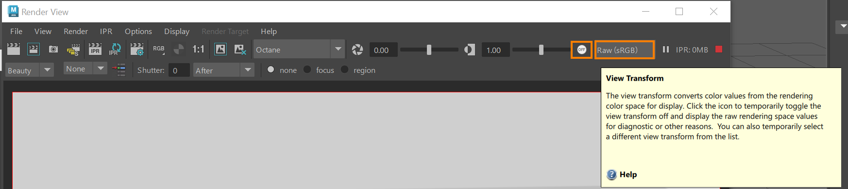

Hi Braca,
As Karu mentioned already, could you please make sure native Maya's color management is disabled in IPR or set to RAW in the image below?
C4d uses Linear workflow while Maya workflow has ACES enabled by default so we need to disable one of the color transform (Octane or Maya)

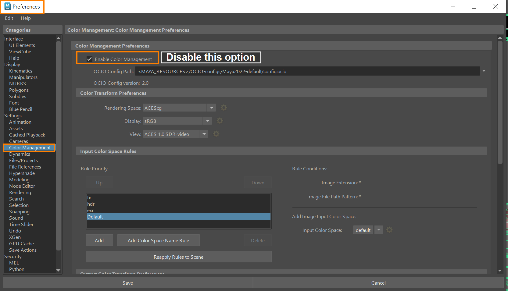

We can permanently disable the native color management from the preferences:
