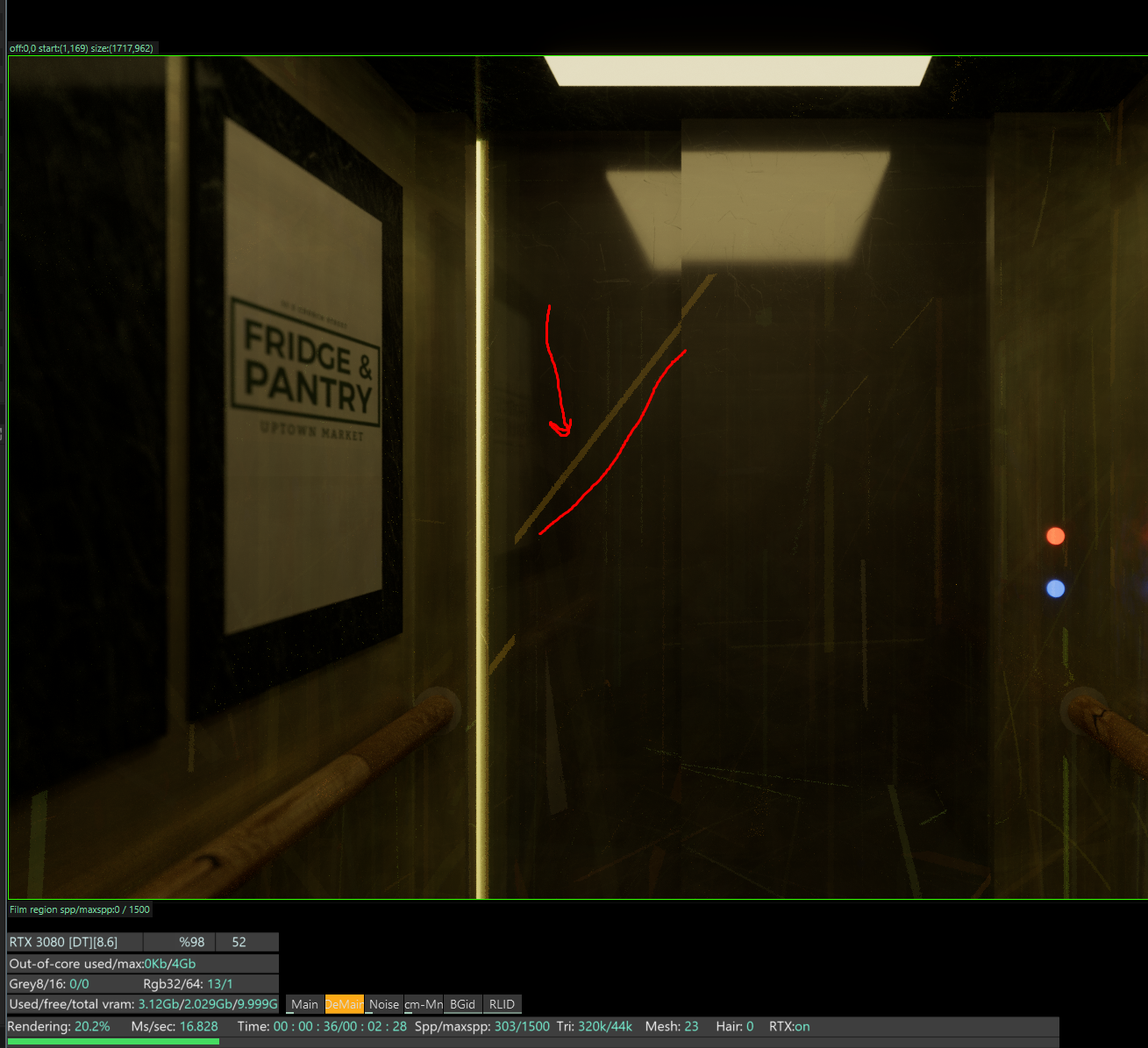

When I place objects in my scene, and when using the live viewer, it is almost as if every object or material is now reflective from the get-go.
I know this sounds confusing, but every material has an almost mirror-like look during the first few seconds of the render. It then continues to render out, and the "mirror" or reflectiveness slowly disappears.
Additionally, when rendering an image, the image would be relatively "pixelated" or noisy in terms of light until the image was rendered out the entire way. However, I now see much less noise and see these light rays or streaks across the screen instead. The screenshot of this is attached.
live view
live view
Is this due to the Octane 2022 update, or is this due to something in my render settings?

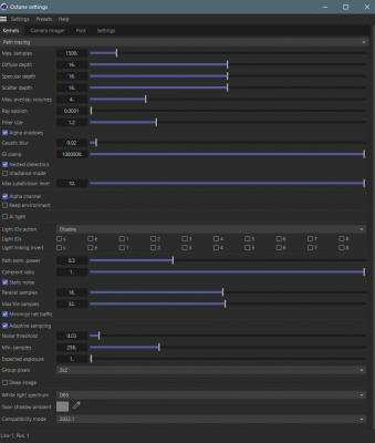

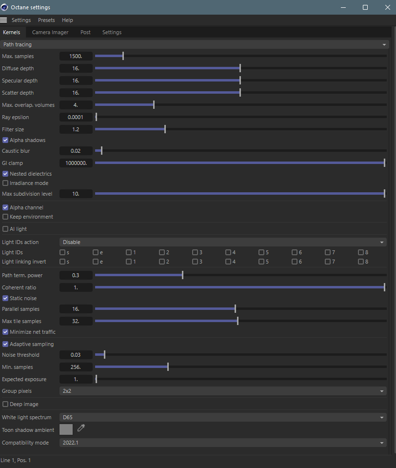

I am using ACES color space as well as PT. Render settings are attached below too.

in short, there ws an issue with c4doctane 2022.1 and new.c4d file, please, upgrade to 2022.1-R3:
https://render.otoy.com/customerdownloa ... R3_win.rar

The most obvious setting which may cause these types of issues is coherent ratio. The default is 0.0, but yours is set to 1
