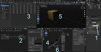

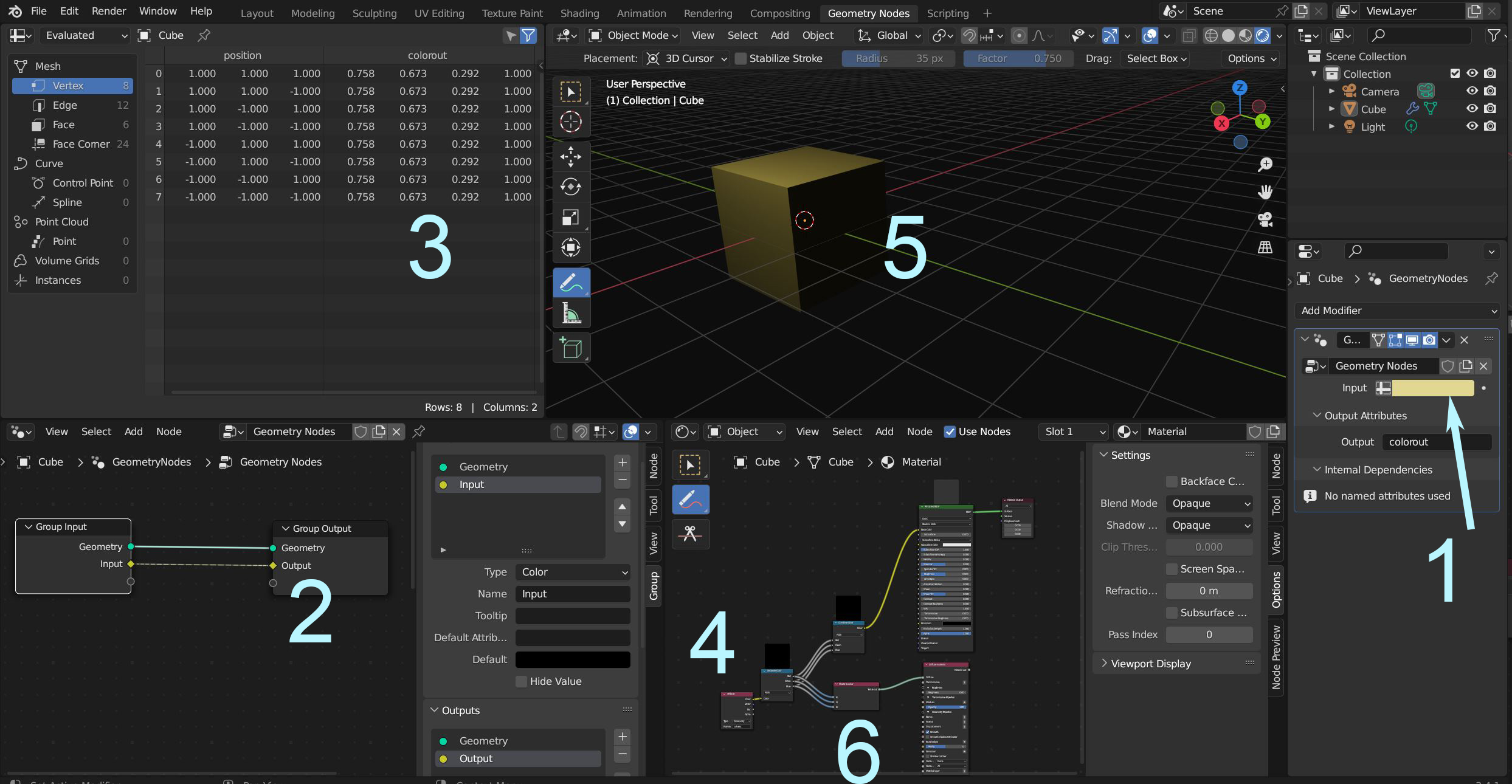

Here I have a minimum blender scene that shows geometry nodes and shader issues.linograndiotoy wrote:We'll do our best to support Geometry Node's Attributes as soon as possible.
It would be great if we could receive very simple scenes using those.
1. by defining geometry nodes we have a input for color at the panel at right hand
2.the color is exported with geometry as attribute
3 the attribute data (color) appear in the spreadsheet
4 through the attribute we transfer the color information into shadings part
5 in EVEE or Cycle's engine, the color is transferred to material correctly, the cube following the input, means the attribute and the color separate works fine.
6 when come to octane engine, the color is not working, I guess the floats to color node is where the issue comes.
Please also see the related topic viewtopic.php?f=114&t=81143
please see the below image and the attached blender project.
