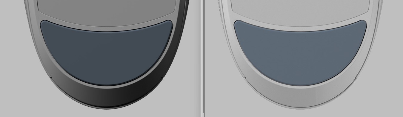

Literally every scene, it will happen with a cube and an hdr sky. I'll send a project privately in a moment but it isnt strictly needed. I've just had it happen again 5 minutes ago, rendering 20 mice and 1 of the shots simply has no sky illumination
