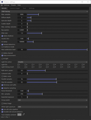

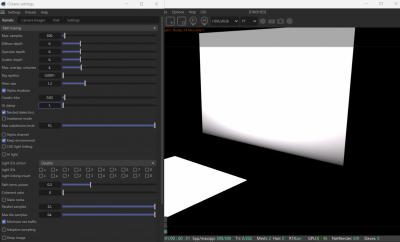

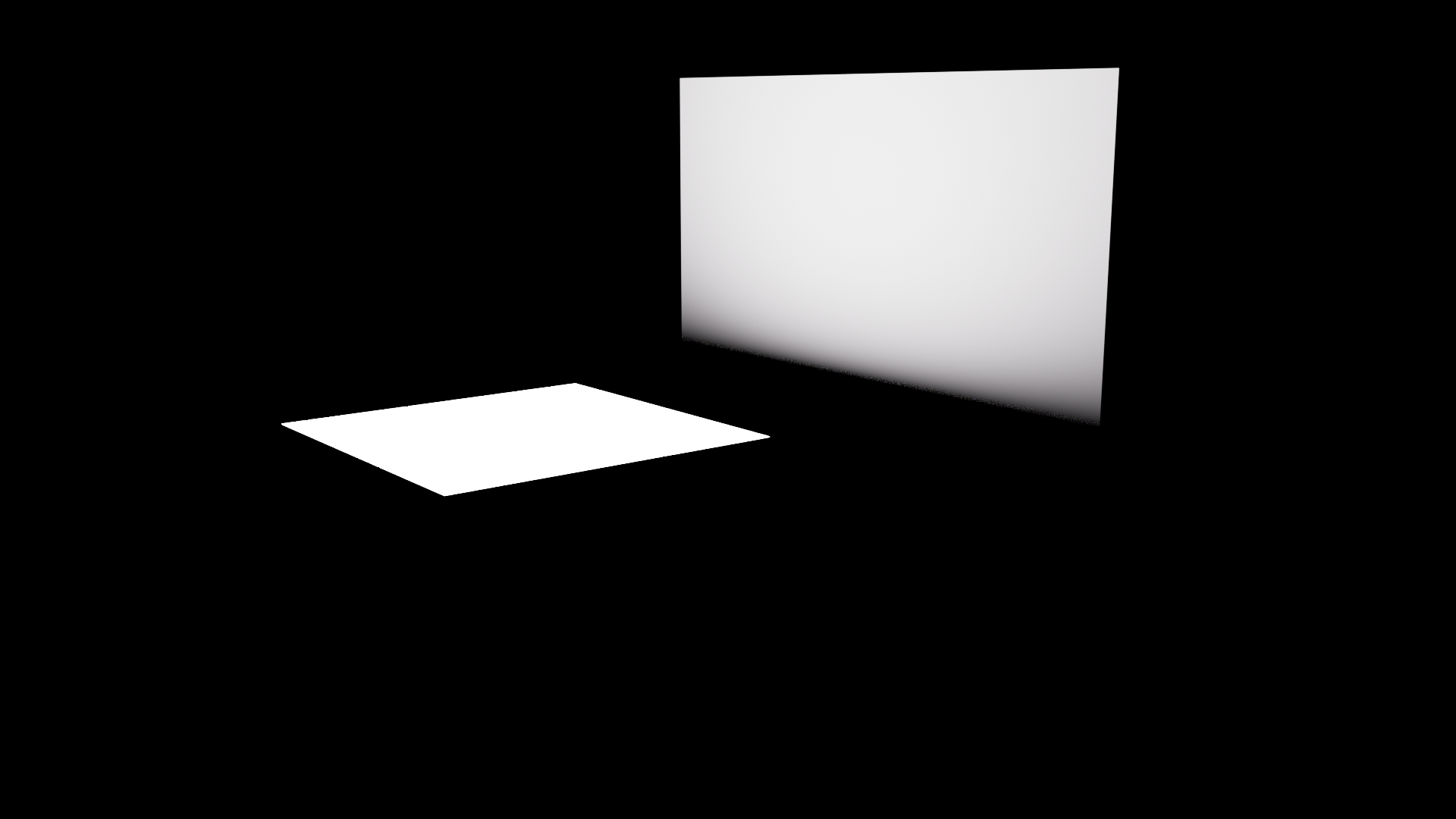

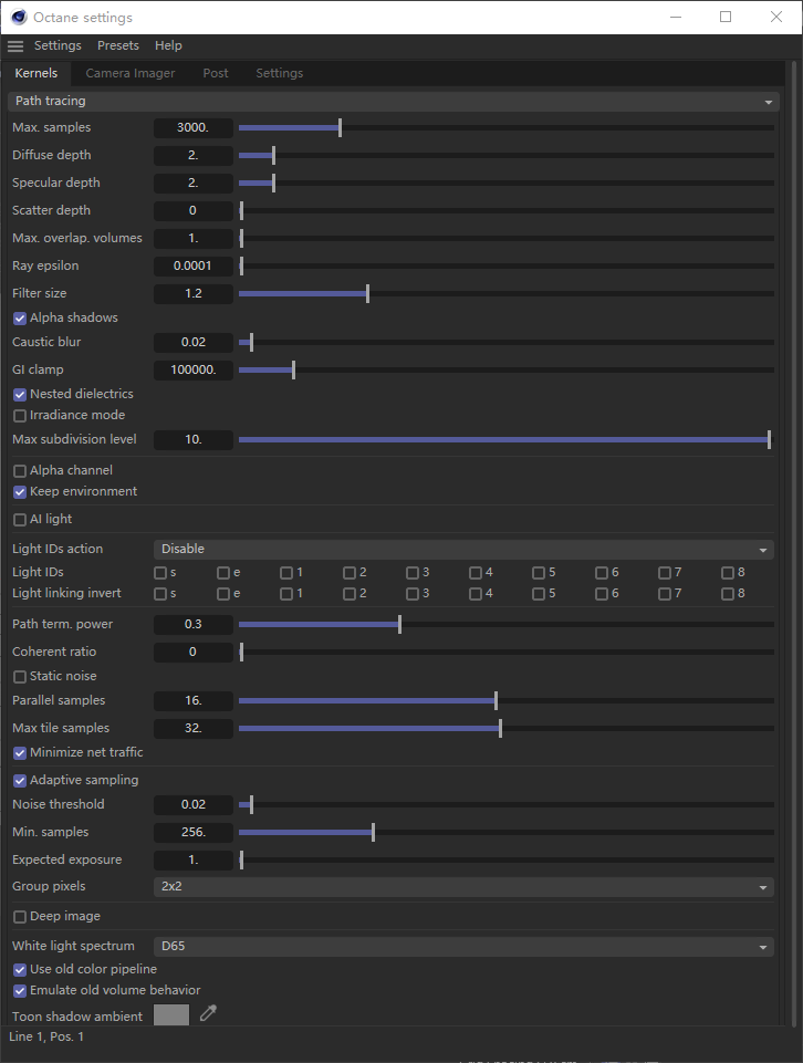

Area light noise on the side is difficult to remove
This is the result of 3000 samples from the PT engine
oc
oc
This is the result of rs double brute force automatic sampling 0.01
rs
rs
So is there any way to render noise cleanly without denoise?

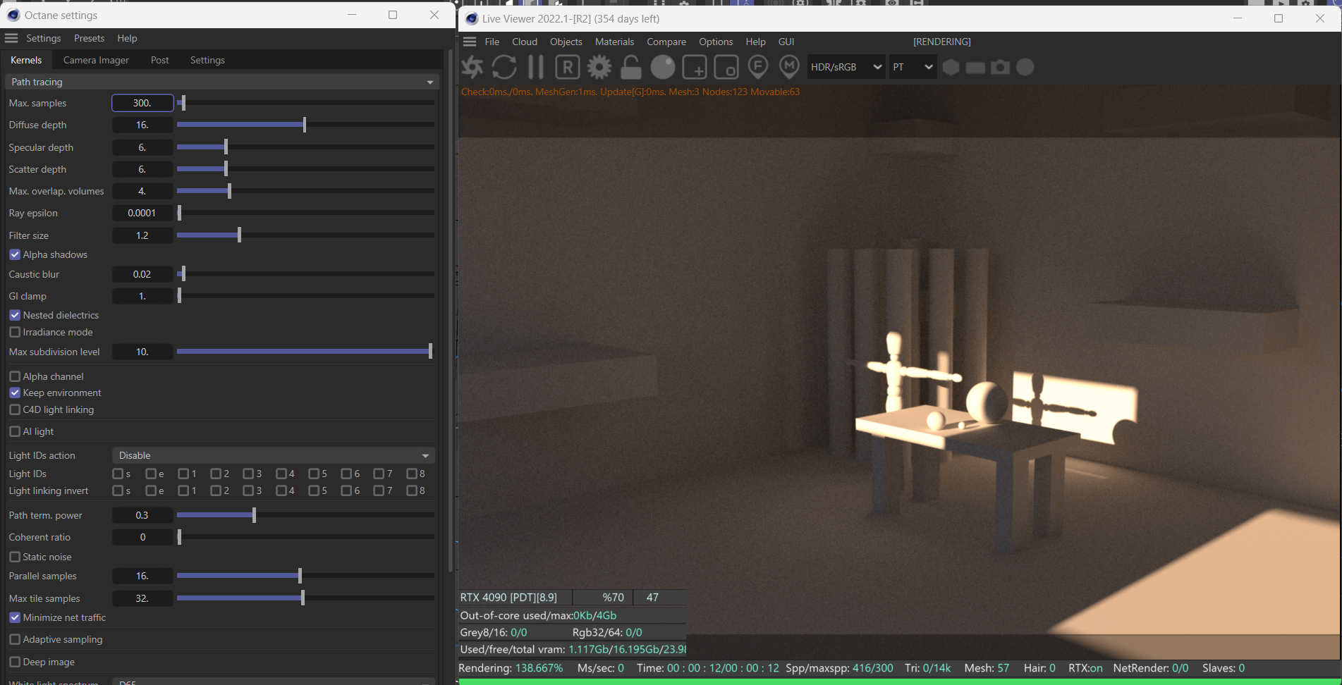

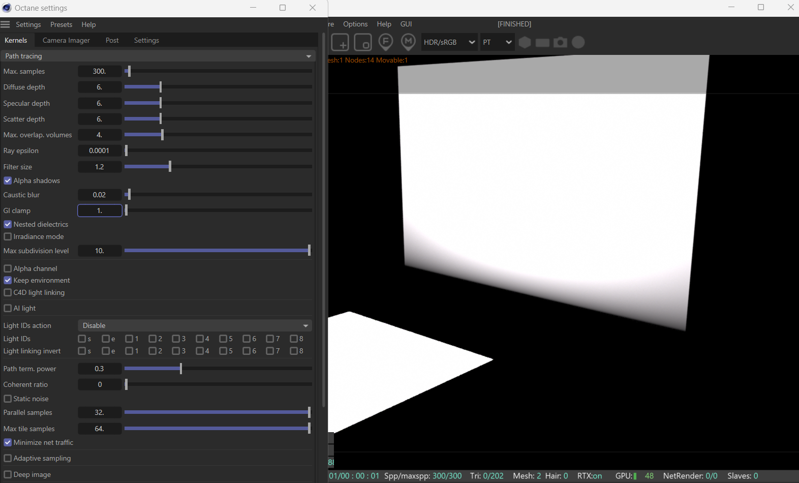

Reducing the GI Clamp to something that fits the scale of your scene should help a lot. I doubt I ever use a setting of more than 10, but it defaults to 1000000. I generally start at 1, then tweak from there, if necessary. This is Path Tracing with 300 samples.
Lower GI Clamp to Reduce Noise

elsksa wrote: That's exceedingly low. Although it wouldn't make a drastic difference in a scene that has weak lights, among some other factors.
Hmm. I'm curious to know your experience with GI Clamp. Here's a quickie mock-up of your example, using an Octane Daylight as the only light source. Yes, it's certainly too noisy at this point with only 300 samples and a diffuse depth of 6, but it's a pretty decent starting point. Using higher GI clamp doesn't improve anything. I wonder what we are doing differently. I'll have to read that page you linked to at lunch.
Interior GI Clamp 1
Interior GI Clamp 1
