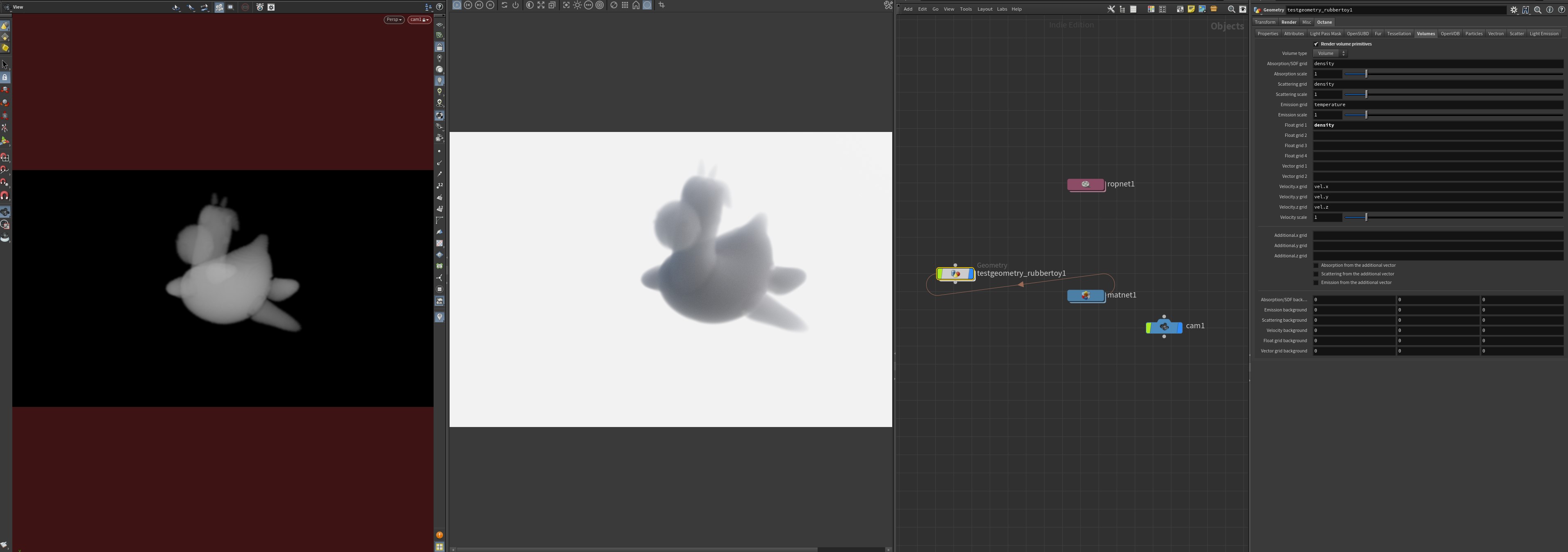

Yes, working with OpenVDB files to cache the volume objects is indeed the best workflow. The OpenVDB files are loaded by Octane at the render time, so the scene extraction time is almost zero, and all the Octane volume rendering features are supported.
Thanks,
-Juanjo
