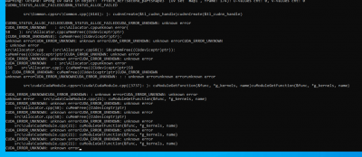

i v got a random stop error while batch rendering, it renders 10/20 frames and then stop on random frames further.
any idea what that message means ?
i m on a remote workstation. If i untick render aov and denoiser it seems to solve the problem but i need at least the denoiser :/
cheers
*i ve turned on extra ram mem use
