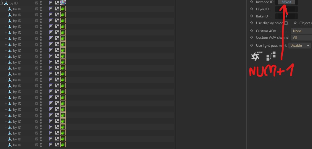

Hi, as I know there is no working OSL script for that in Octane but you can use three methods :
1. Using Octane Instance ID for different objects :
It needs some preparation. Individual polygons should be extracted to objects using C4D Polygon Islands to Objects. After that Octane Object tag is needed for all of them, select them all and in Instance ID put "num+1" to make every object individual Instane ID number.
