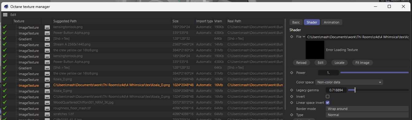

In the attached screenshot, one line is highlighted which lists a full file path to a texture. That file path is invalid and does not exist, however octane shows this entry with a green tick as if everything is fine. The "Koala_D.png" file that it refers to is indeed in the active project's /tex folder, however it is not located at the full file path listed which is from an older deleted project.
When rendering, the file is not found and does not render correctly (as expected)

Texture manager shows green tick on missing files
