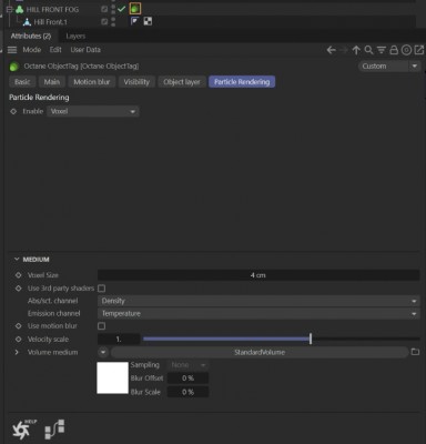

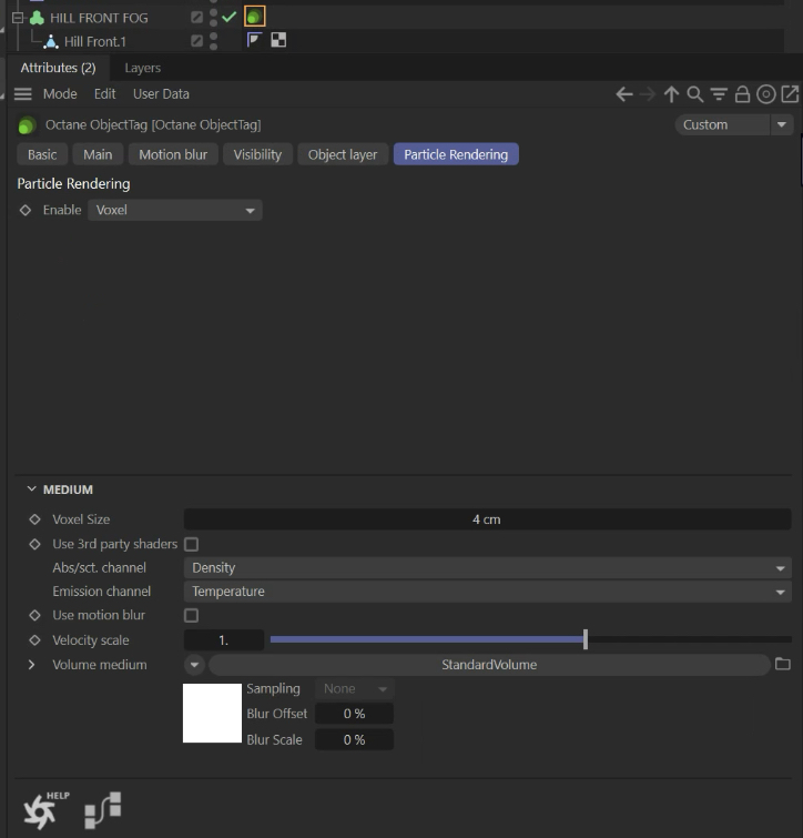

just like Pyro, add an Octane Object tag to Volume Builder object, to be able to directly use Volume Scatter, or Standard Volume nodes:
ciao,
Beppe
