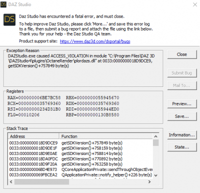

Another collapse inputs crash.
DAZStudio_error_report_221206-190925.zip
(144.43 KiB) Downloaded 124 times

SiliconAya wrote:Another collapse inputs crash.
Thanks. Can you please export the material that you were collapsing as orbx and PM me? And let me know which node you were collapsing.

toby_a wrote: Thanks. Can you please export the material that you were collapsing as orbx and PM me? And let me know which node you were collapsing.
Unfortunately it doesn't look like I can, it was something new to the scene so it wasn't saved when it crashed and I kept working on the scene after the crash, so I can't remember what it was now. I've tried what I thought it was, but can't reproduce it.
What I do remember is that it was a auto-converted material and I did a 'Collapse inputs' on the base Glossy material node.
