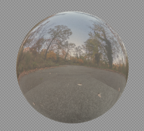

a Clearer render to see the plane in the reflective sphere

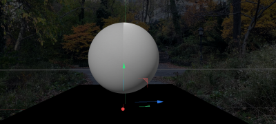

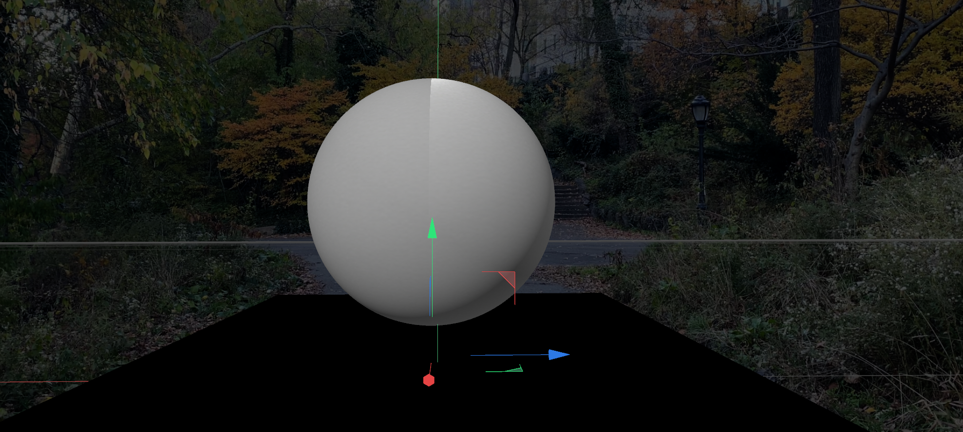

Simple setup
Simple setup

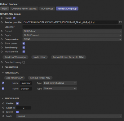

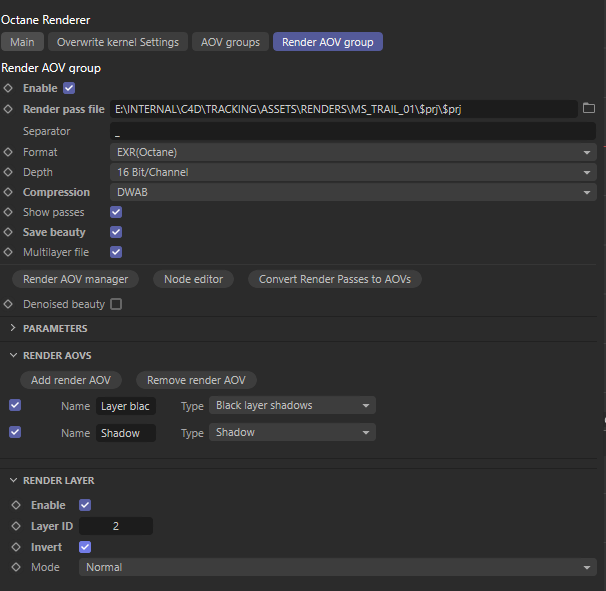

My render settings get me the passes I neeed.

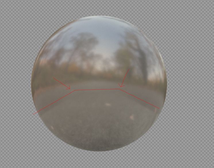

here you can see the plane in this ball
