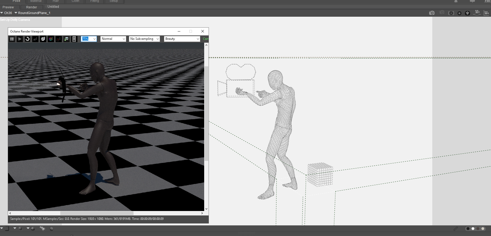

Huzzah Paul, I figured out how to animate a volumetric Procedural Light in Poser also how to animate it as well using Poser within the standalone. Which is normally impossible.face_off wrote:Yes, it would be amazing if the plugin could do that - and it's the way I originally intended the proxy system to work, but unfortunately I could not get it to work correctly. You can animation a mesh in Poser, then export to ORBX, then open the ORBX in Standalone and add the Geometry Out node (and connect it to the exported ABC file) and this use that ORBX as the proxy. But it's not as easy as using dials I agree.spartan00j wrote:I had thought if there was a way to access the XYZ trans and rotation or possibly even scale within the plugin itself.
Paul
I used a technique on this thread.
viewtopic.php?f=73&t=78540
I wanted the ability to parent the Volumetric Procedural Light to something like a geometry or figure. But when the Standalone Imports and animation there are no transitions on anything. Except for one thing which is in that post.
The cameras!
So basically I parented a camera to the figure's hand. And bake that animation in. Because octane will not export that camera unless it's parented to the universe. Once I baked the animation. I unparented the camera from the hand and to the universe and poser. I hide everything else and then just exported the camera animation. When I opened it in octane. I used the trick within that thread and just have the light transitions attached to the camera transitions. There are some slight adjustments you may have to do to put it directly in the place that you wanted. But with all things considered it's the best solution. Especially since you cannot really animate that camera easily in a standalone itself. So with all that being said, Paul. Is there a way to export an object out with just a camera animation tag that octane will read as if it was a camera. Like if I have two cubes in a scene bouncing around. Instead of using the method I just developed. Is there a way to tell the plug-in to view this object as a camera so it can export out the animation that octane can read?
I ask because if I have a ton of ceiling lights I want to have lights on. I don't want to have to create tons of cameras and attach them to whatever cable I'm swinging in the scene.

I don't think this is possible, sorry. When you export a scene animation to ORBX/OCS, the Octane API saves the camera position/transform as an animated transform, and removes all geometry and light transforms and just saves their vertices in world space. I think that this point you are hitting the limits of what can be done in Poser with the Octane plugin and may need to look at a host app with more controls, such as Modo, Blender, C4d, etc.So with all that being said, Paul. Is there a way to export an object out with just a camera animation tag that octane will read as if it was a camera. Like if I have two cubes in a scene bouncing around. Instead of using the method I just developed. Is there a way to tell the plug-in to view this object as a camera so it can export out the animation that octane can read?
