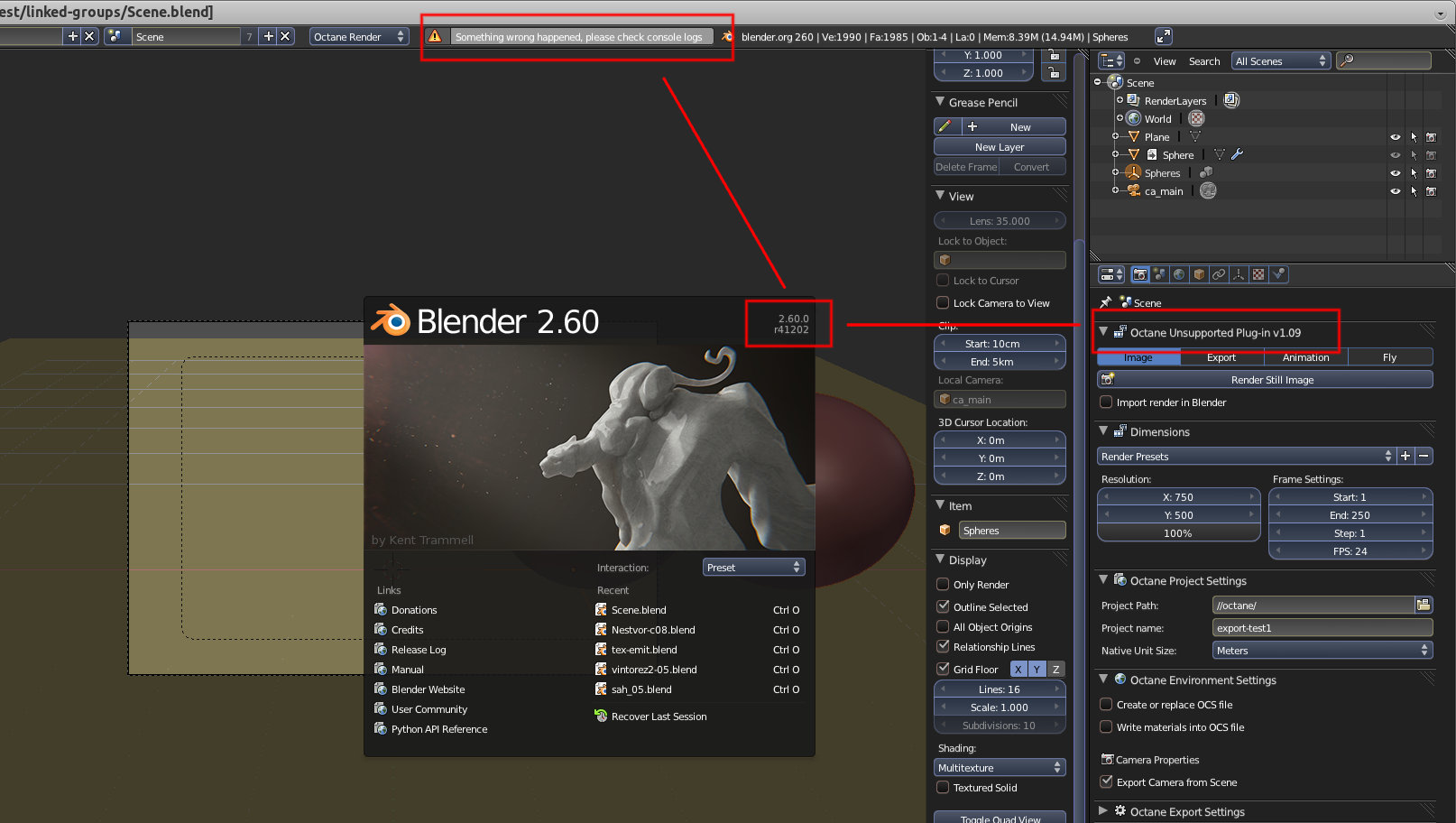

Hm, I still get the error with 2.6
There are two spheres in my Scene, th one that doesn't export is the linked group -> it's attached to an empty.
