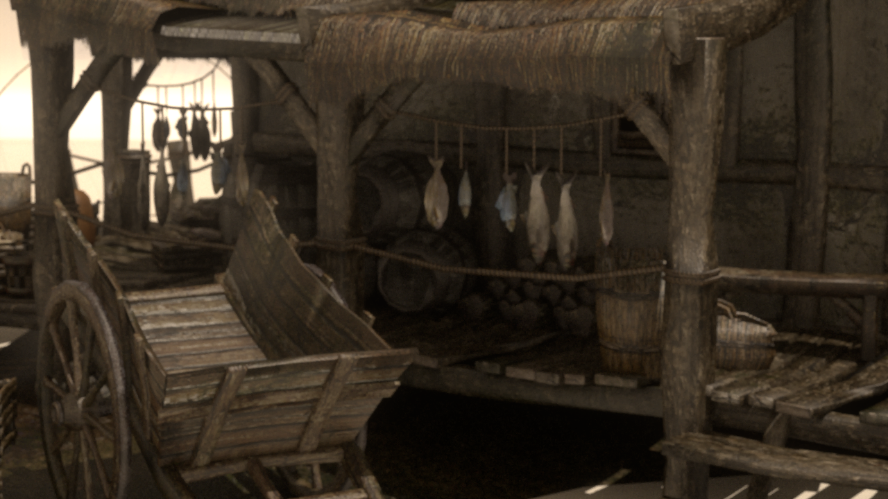

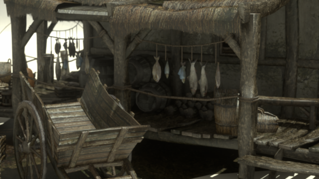

I am not sure what a reference scene is specifically but I updated my drivers, loaded up a random set I had in my runtime and gave it a shot, running the sample per pixel count up to 450 or so. After some settings trial and error the culprit appears to be linked to RTX acceleration, of all things. While in Poser11 (Octane 2020.1.5) it tends to give me a 30% speed boost, in Poser 12 (Octane 2022.1.0.117) or Octane Stand Alone (Version 2021.1.6) using RTX acceleration actually slows things down by about 300%
In terms of hardware I have a 3080 (render only) and a 2080 (render and display). I was rendering on the 3080 but in Poser 11 I need to add the 2080 for the denoiser and imager.
Poser 11:
With RTX acceleration: 9 seconds with 40 MegaSamples per second
Without RTX acceleration: 14 seconds with 30 MegaSamples per second
Poser 12:
With RTX acceleration: 55 seconds with 8 MegaSamples per second
Without RTX acceleration: 18 seconds with 25 MegaSamples per second
Octane Standalone:
With RTX acceleration: 52 seconds with 9 MegaSamples per second
Without RTX acceleration: 15 seconds with 30 MegaSamples per second
I am not sure what's going on, but it is the opposite of acceleration.
