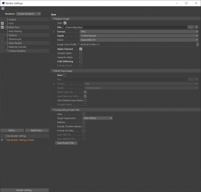

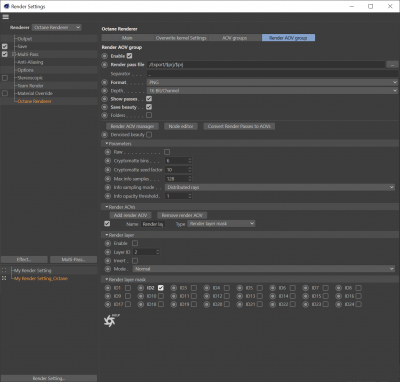

Hello, so I have collected a the projects and also i have created screenshots. I really need a help with this.
I do remember in some version of Octane I must to use the beauty AOV pass to get the right beauty image... I could not use the base C4D render save option there...
Please can someone help me how to render with octane, when I need for example Render layer ID and just beauty image? Should I use the standart method option in C4D or just Octane AOV passes?
Please take a look on attached project and also take a look on image screenshots.

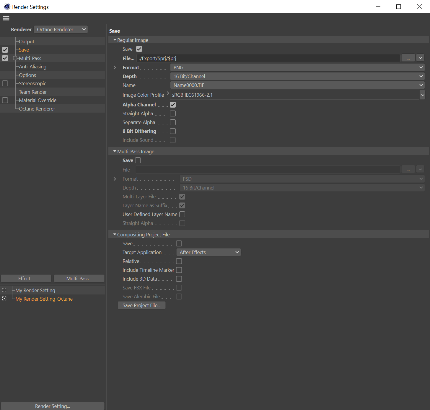

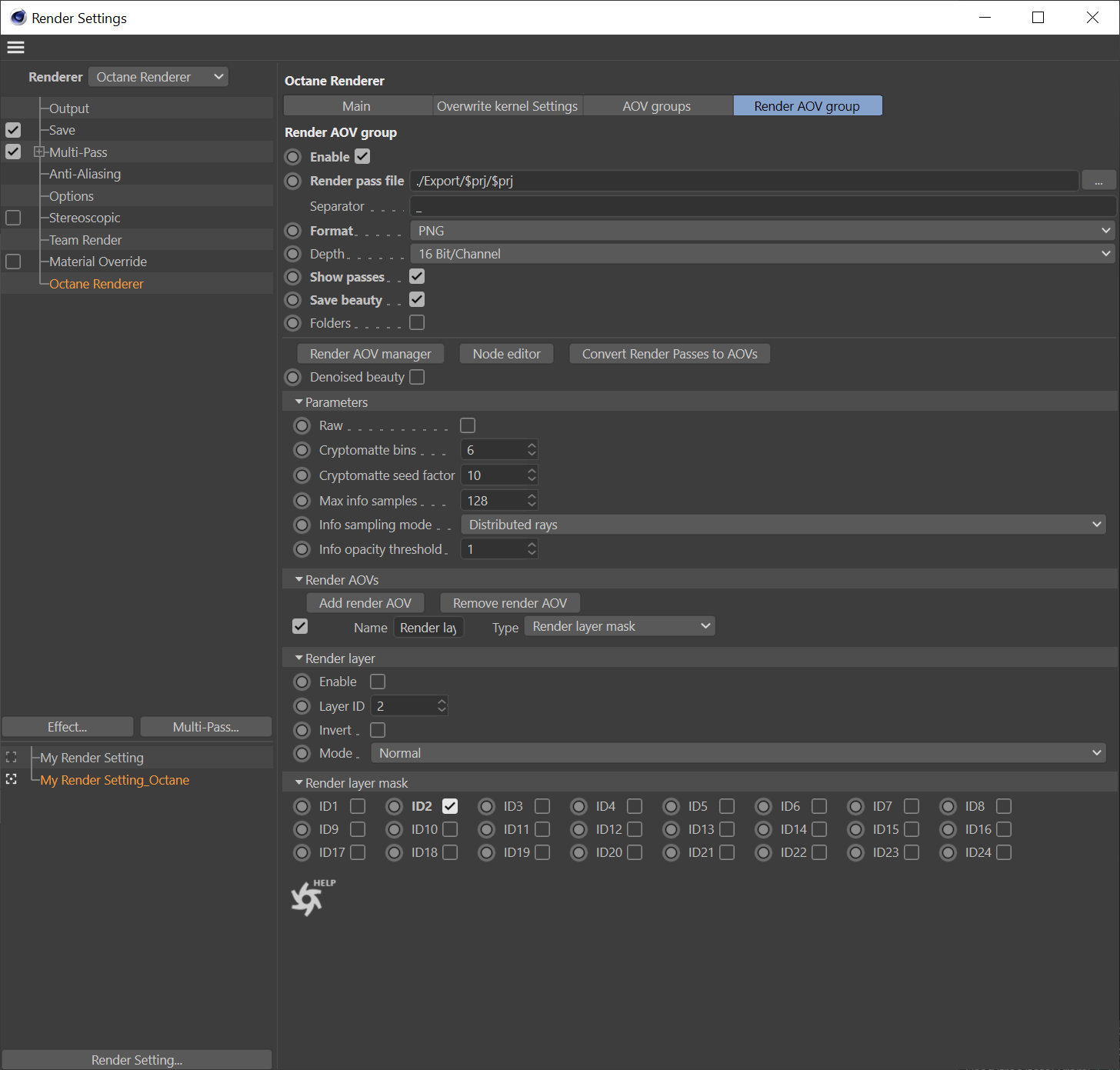

I'm not sure I follow exactly what's happening after looking at your attached files but you will always need to have both cinema and octane save their files, and just ignore cinema's files. I recommend using tokens to control where they get saved to.
Also you might get the behavior you're looking for from cinema's save function if you set the Render Settings> Octane Renderer> Main> Buffer Type: LDR 8-bit. I believe you're looking to receive a SDR image and not a linear/HDR image so that change should help hopefully.
