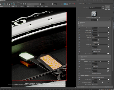

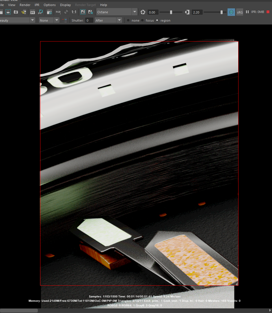

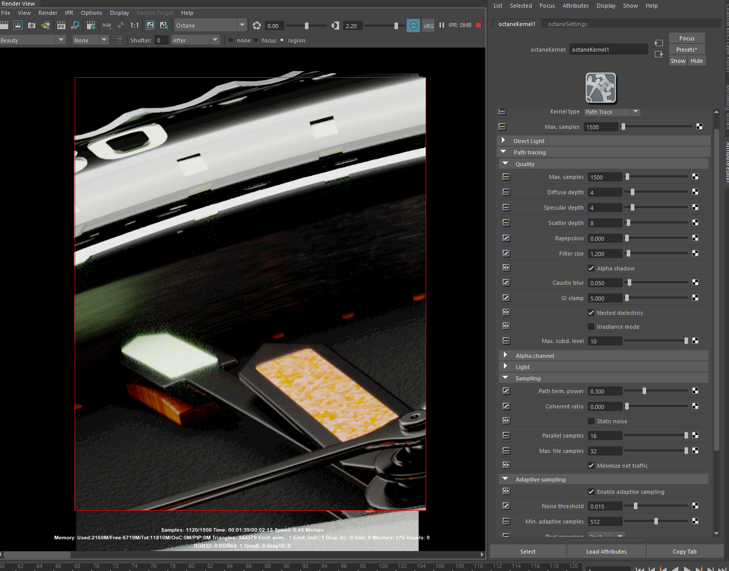

I ve got to do a very close up shot with a very thick glass and guess what : noise
I ve tried to play and match settings from different posts but it seems that there is no clear way to speed up rendering.

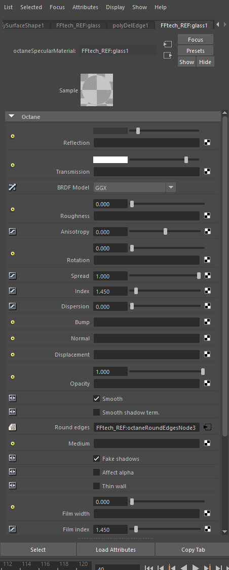

When you look at the first image with the glass activated, it looks like there s a halo on the green/white. I cant figured out where that come from, no roughness on the glass shader and no post effects. it could be a clue to figured out the noise.
My lighting : octane plane light with a gobo texture. Before that i had an hdri. With/without textures, that doesnt seem to change anything for render times.
I d like to keep caustics with PT kernel.
Also, the glass mesh has the exact same topology on the front and back, so no weird distortion. Perfect normals.
I use a lot redshift but i wanted to again give a try with octane for a better realistic look : it works great on distant shot but here on close up i m a bit stuck. The rendering time could be fatale.
Any clues ?
Cheers
without the glass
without the glass
with the glass
with the glass

Solving caustics is fairly expensive but there’s a few things you can do to speed up render time without using fake shadows.
Maybe a combination of the following will help:
-Use AI lighting mode with the primitive light models (won’t see benefits with geo that’s emissive / only primitive/spectron lights )
-Decrease the hotpixel removal from 1>0.7-0.8
-Decrease GI clamp to <500
-Increase caustic blur as high as you can while still seeing the caustic effect.
-Decrease specular and glossy bounces as much as possible
-Increase parallel and max tile samples as high as possible (limit will be the sliders or VRAM)
- turn on adaptive sampling and increase the threshold while still being acceptable.

thanks for the tips. I tried and didnt found a magic wand to get the noise down with a fair amount of render time. I guess it s just the way octane is built.
Isn't there a possibility that a medium on this thick glass would help the calculations ?

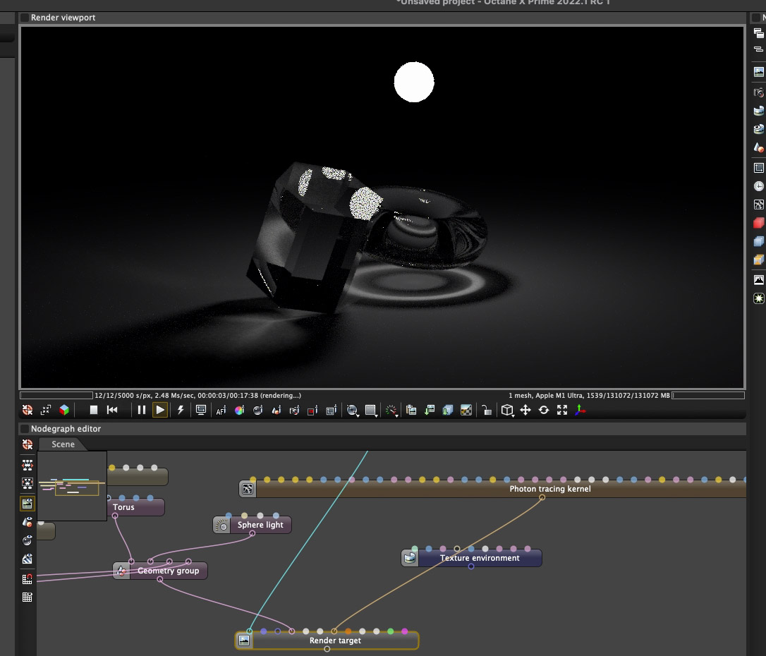

Thanks for the advice and underlining the new 2022+ photon tracing kernel
I'm tryin that very soon on M1 and put a feedback here.
Another question, would it be interesting to low res and blur the hdri (environment) and specify in the visible environment the original one (6k) ?
I remember that this blur hdri thing would help for noise in previous/other renderers at the cost of a blurrier/not as sharp lighting/shadowing.

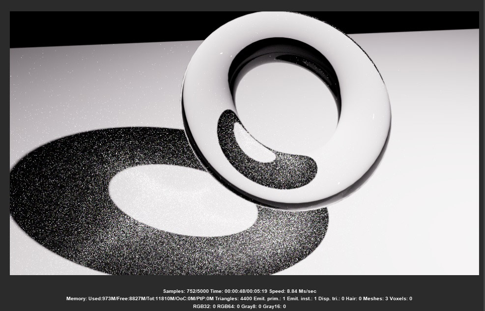

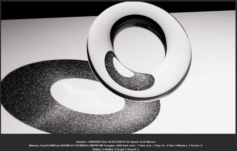

So i tried a basic scene on my win/maya2022/2022RC1/1080ti config
The photon tracing straight out of the box doesnt bring any speed :

great thanks ! i gave a try on the standalone 2022RC1 : that s awesome, the speed for rendering caustic is phenomenal... !
I ll dive into the guide asap.

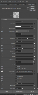

Tho, there's a little issue : no checkbox for "allow caustics" in the maya plugin... (it s a specular mat)
any clue ?

AdrienG wrote:great thanks ! i gave a try on the standalone 2022RC1 : that s awesome, the speed for rendering caustic is phenomenal... !
any clue ?
Hi AdrienG,
Thank you again for reporting this issue.
We have requested our dev to implement "allow caustic" checkbox in the future release!
cheers
Kind Regards
bk3d
