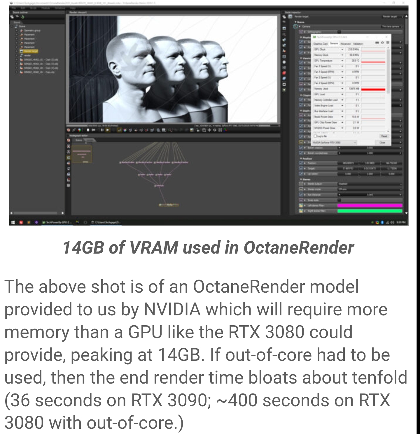

glimpse
Posts: 3740
Source: https://techgage.com/article/nvidia-gef ... rformance/
Sounds very much like Your situation, so I'm not sure where the claim comes from
its a long held belief but it is not the case
In any case, looking to Your findings.
