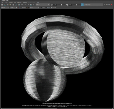

Hi everybody,
Simple noobie question i guess :
Once i plug a proc noise in bump it bring me hard edge.
How to fix that ? cheers

AdrienG wrote:Hi everybody,
Hi AdrienG,
Thank you so much for sharing the rendered images.
Would you please try using the **OpenSubD level** from the Attribute Editor>Octane rollout and see if it goes away?

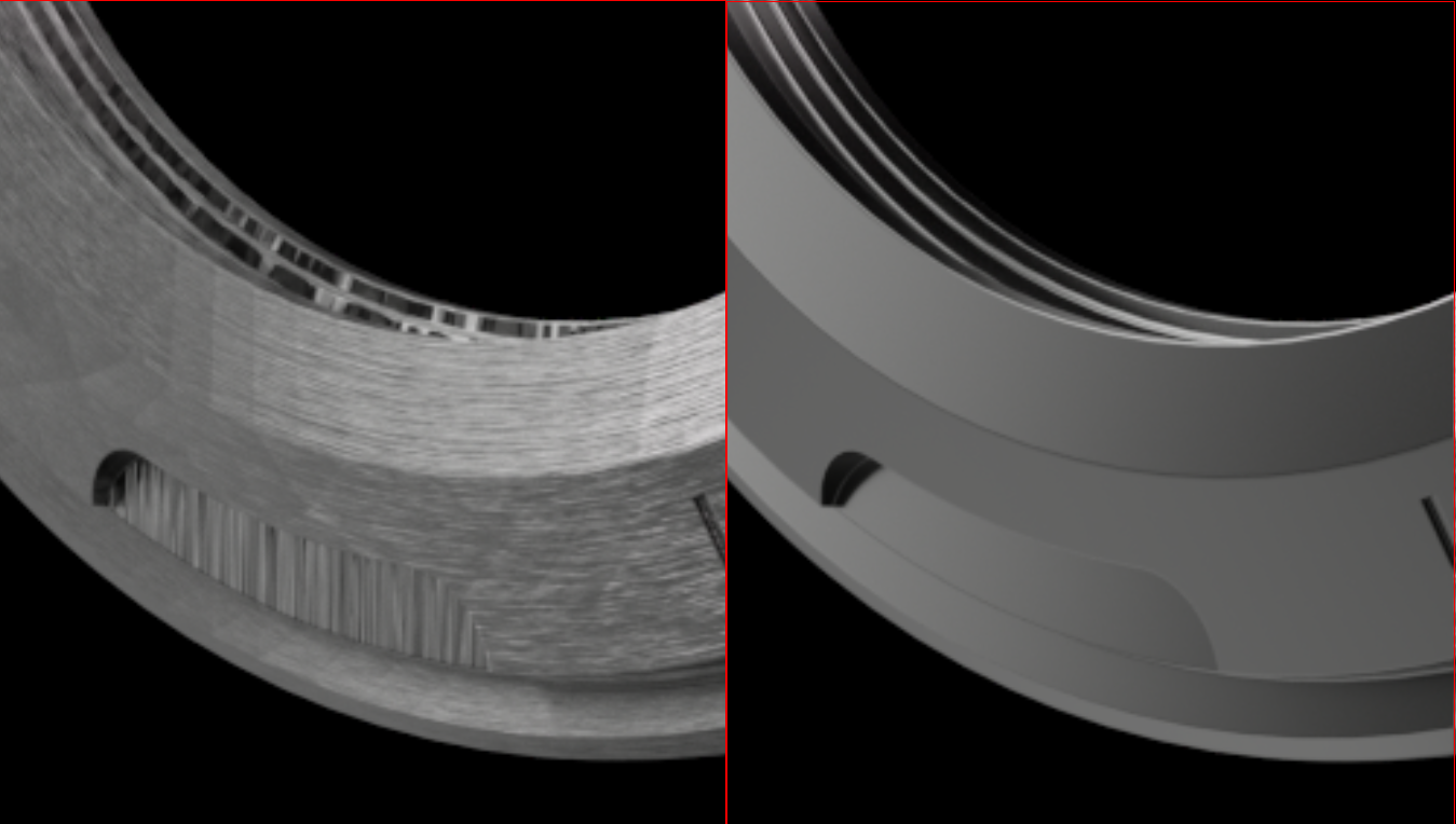

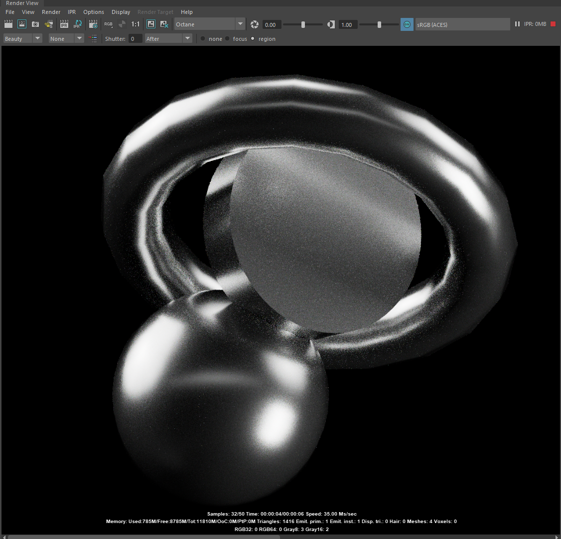

i need help for that because i cant figure out whats the issue, to me it looks like a plug in dev problem, hopefully you ll tell me i m wrong.
Whatever i do with my normals (soften/lock unlock/vertex/faces...) the bump (a basic oct noise) is bringing that hard edge look.
I share another render comparaison.
plus, a very basic scene with a torus if you want to try.
Cheers

edit : cant send *.ma here but the scene is the most simple, torus with noise bump : impossible to get rid of thats edges, to smoooth them out....

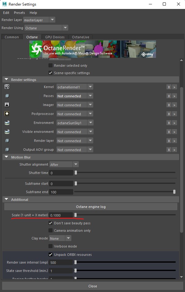

Maybe your model size is too big
try it. scale 1=>0.1

Scene scale didnt bring much and to my mind thats a dangerous setting to play with.
