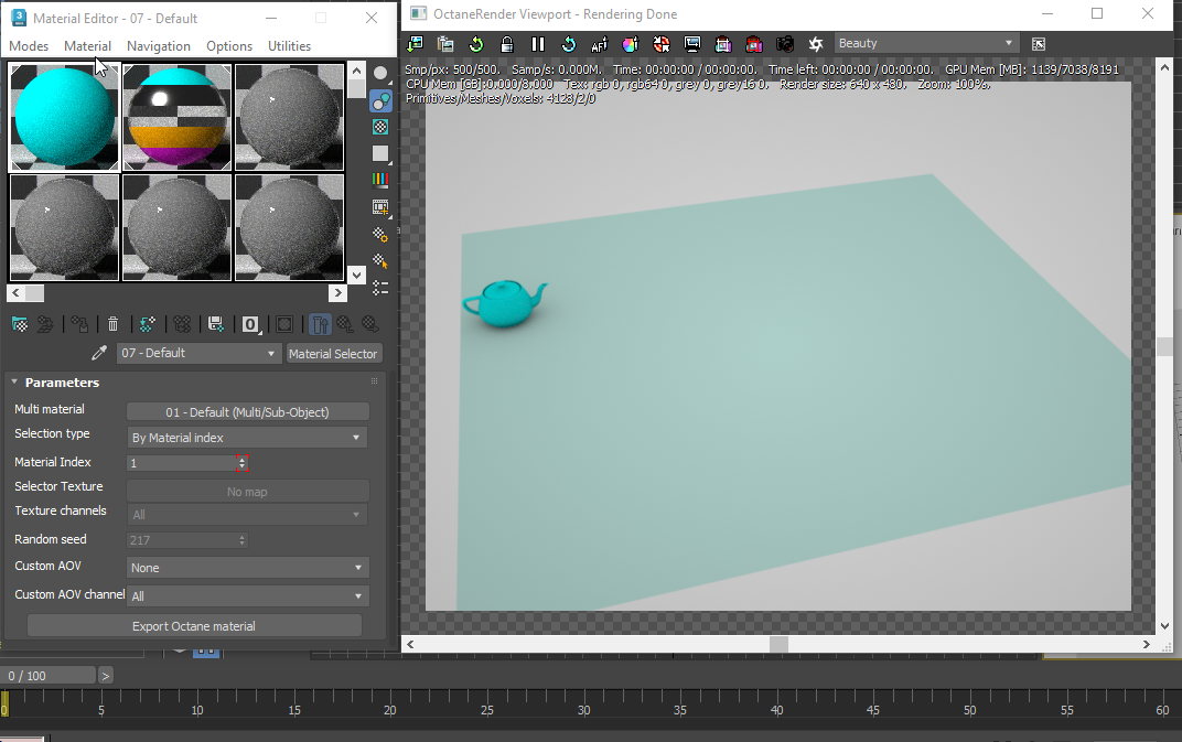

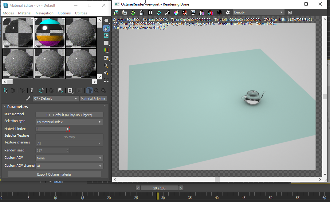

Material are selected by their index, from 1 to the material count.

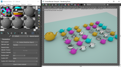

- Random material
Set the Selection type to 'Random'
Use the seed parameter to generate different random distribution.
Internally using an Octane Random Color texture, this generates values that are used to select one of the material.

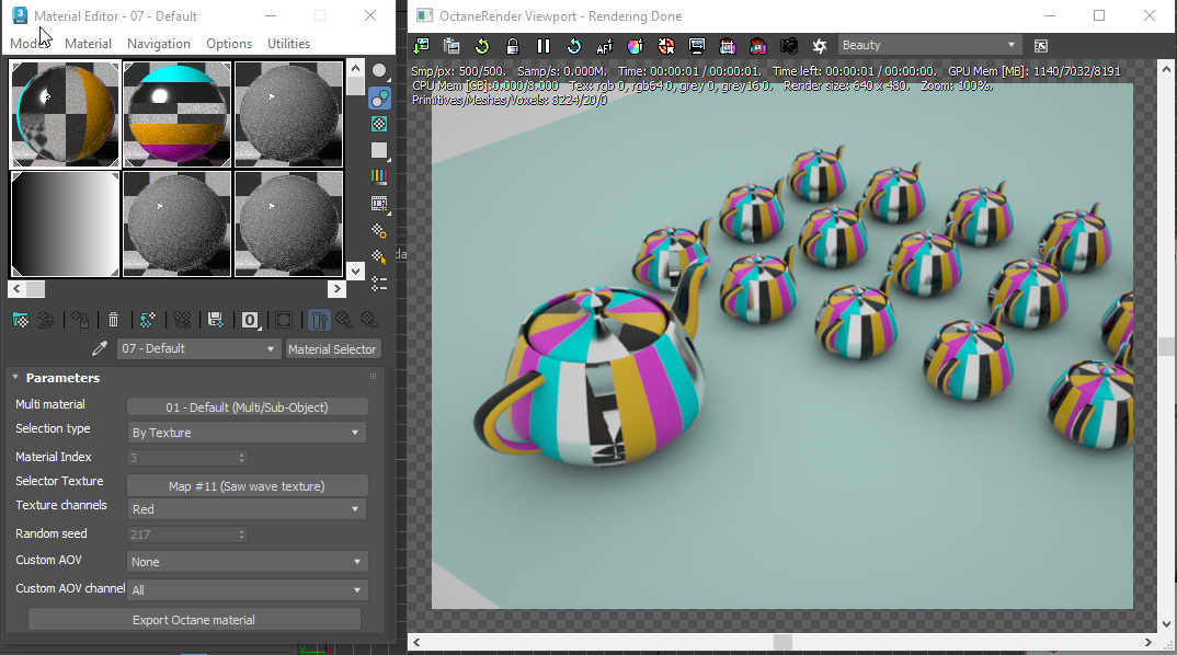

- Generic Octane texture.
Set the Selection type to 'Texture'
Any texture can be used to select one of the materials.
A grey scale texture, with ranging output from (0,1) will select a material in the range (1, material count)
For color textures, you can specify the color channel to use, or All to consider all the rgb channels.

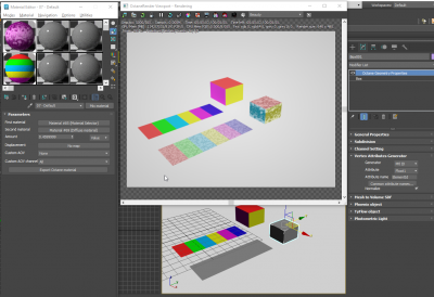

UPDATE (from 13.16) : Addition of the 'Material Index' generator.
To apply materials from a multi material using the Material selector, the Octane Geometry Modifier has options to generate the appropriate vertex attribute.
The use of Material ID ('Mtl ID') as vertex attribute can gives incorrect values.
It is preferable to use the new Generator mode 'Mtl Index'.
The 'Grayscale vertex attribute' texture is used to read values based of the material ID of the mesh
This match the 'Mtl Index' that must be set in the Octane Geometry Modifier, and both are set with the 'MaterialIndex' attribute name.
This creates grey values from dark grey to white, that can be used in various ways, especially as selection method in the 'Material Selector' material.
Here are some updated samples:
MaterialIndexSamples.zip
(620.14 KiB) Downloaded 265 times
Blended_multiMtl08.max:
Plane materials, as seen from top to bottom:
-Plane002 : a default multi materials with simple colored materials
-Plane004 : the 'Grayscale vertex attribute' set as diffuse texture
-Plane003 : a Mix material with a Material selector and multi material to select 6 colored materials, mixed with a material with a Marble texture
MaterialIndexSamples03.max:
-Plane006 : a Mix material with a Material selector and multi material to select 6 colored materials, mixed with a material with a Marble texture
-Plane003 : the 'Grayscale vertex attribute' used as input of a Gradient texture
-Plane007 : a Specular material with the 'Grayscale vertex attribute' used as Transmission
-Plane009 : a default multi materials with 6 textured materials
-Plane010 : a Mix materials mixing 2 Material selectors
