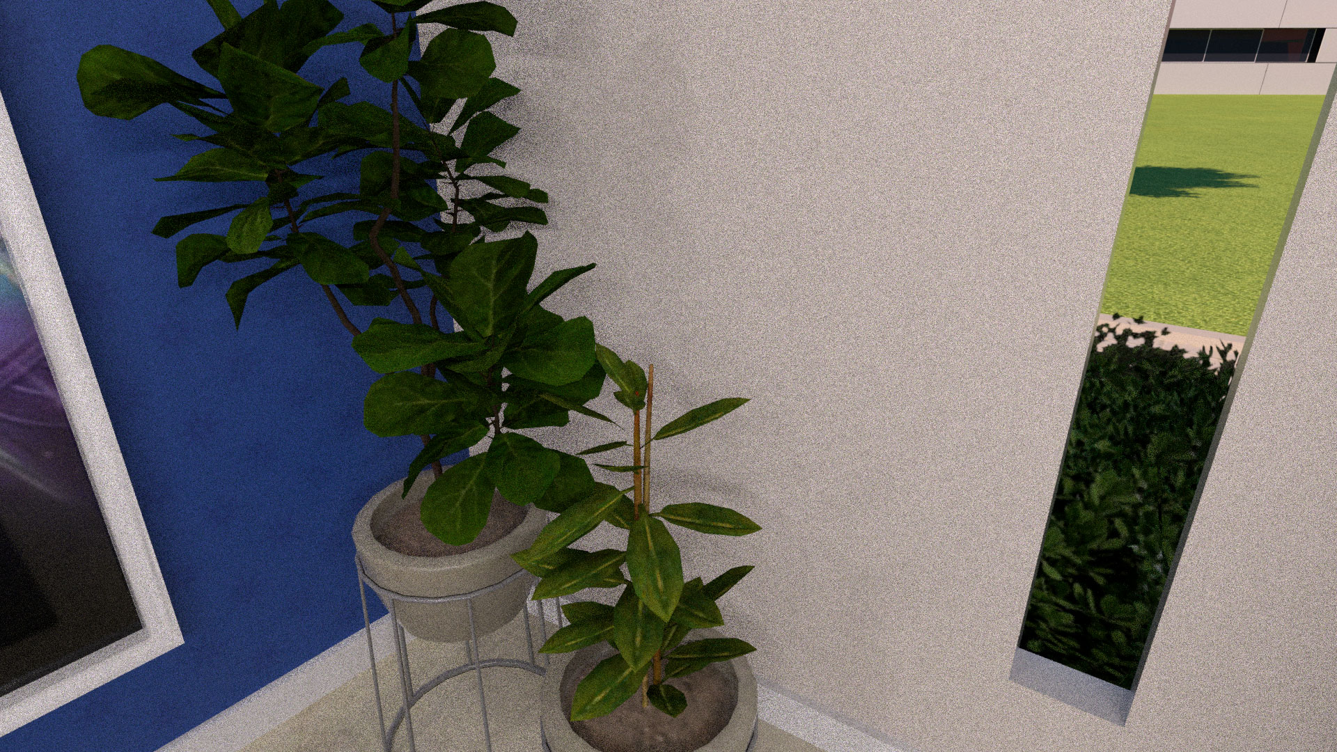

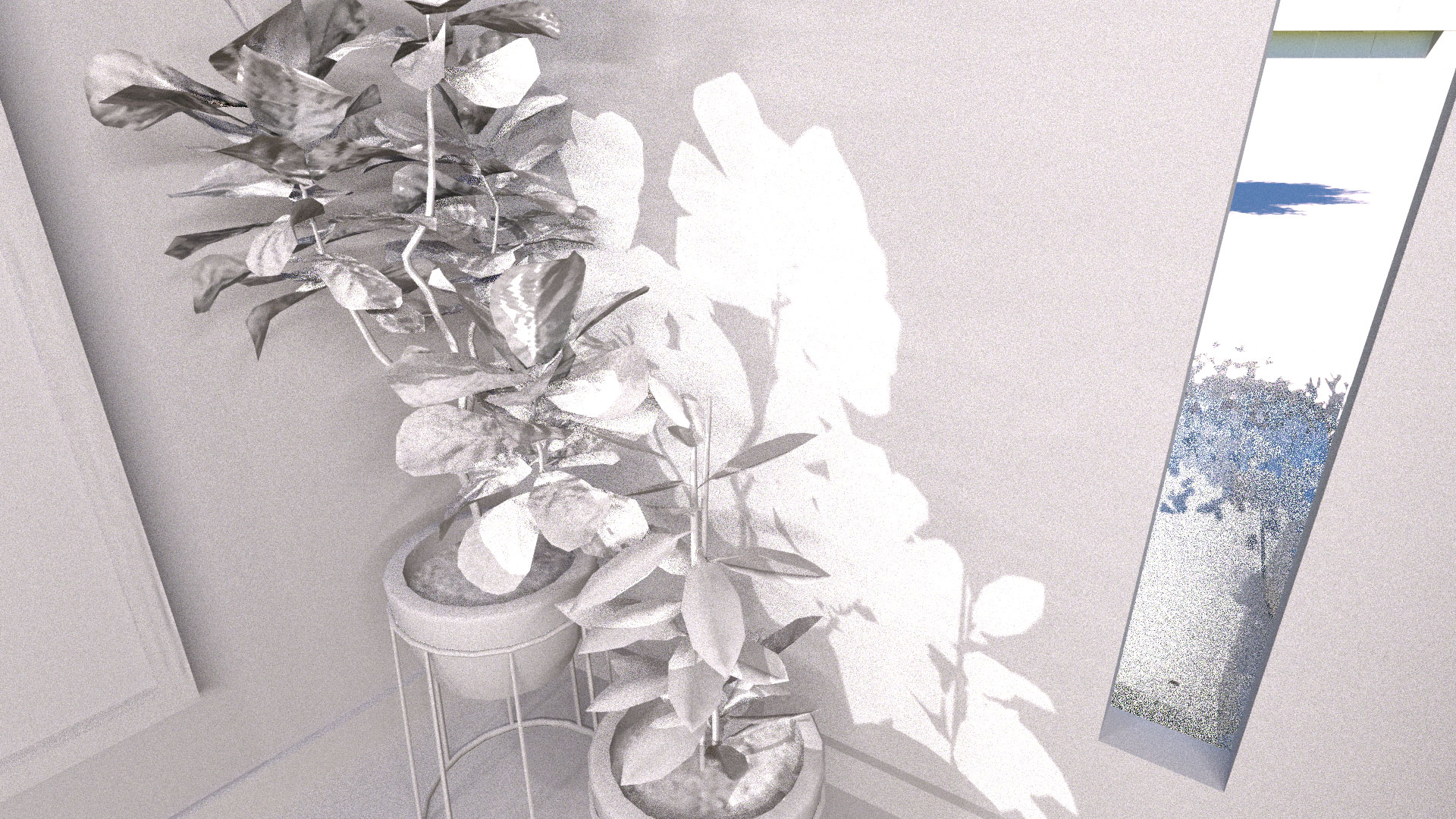

Having a bit of an issue when attempting to render out an irradiance pass, where this foilage in the planter is casting a white shadow? I've tried changing materials, separating/combining the mesh, and a few other things. Anyone ever see something like this? It's been perplexing me. Beauty and Irradance reference attached.

Further exploring, these artifacts are happening to any mesh in the scene that doesn't have backfaces. This is an environment meant for the web so there are lots of objects that have had un-seen back parts of them cutout to save UV space for lightmap bakes.

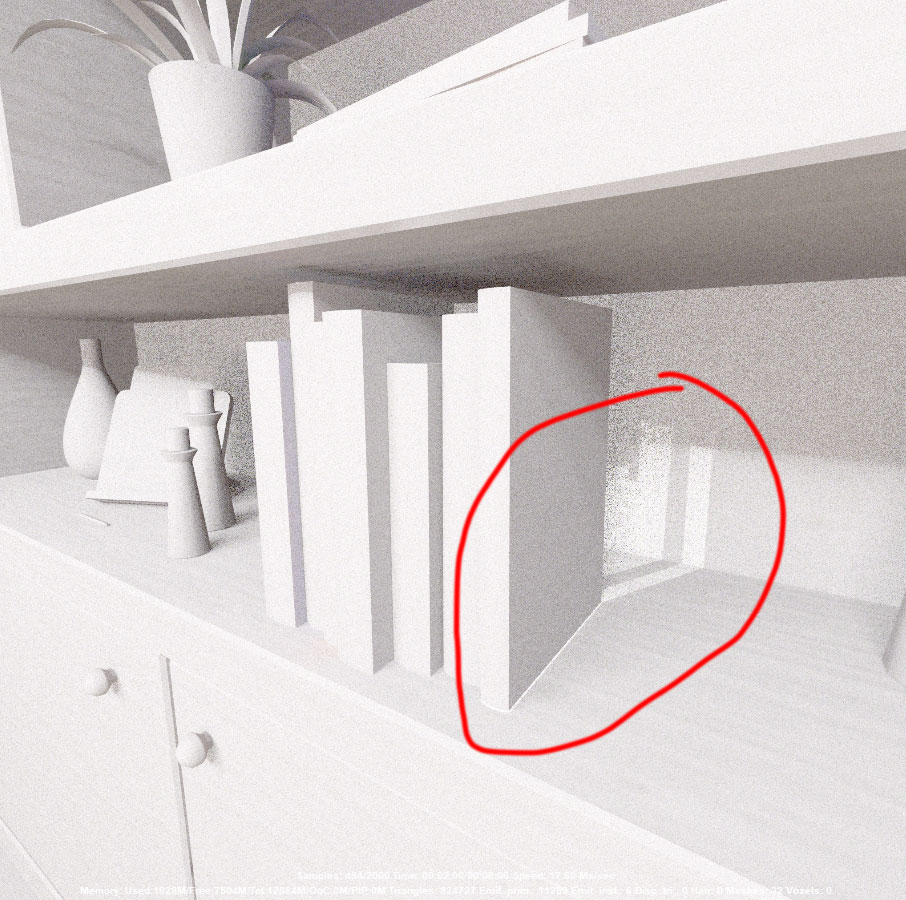

Another example here, with these books having no faces on the back side, it almost looks like they're emitting light.... Was really hoping to create a light baking pipeline utilizing Octane but this is sorta killing that possibility.

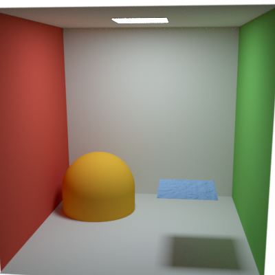

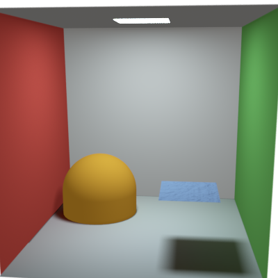

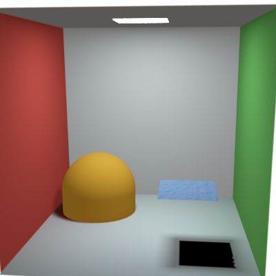

Can you confirm if the white areas become transparent if you enable the alpha channel?
In irradiance mode, areas where shadow rays reach backfacing polygons are made transparent. This avoids black edges where objects intersect the ground.
If this peculiar behaviour is a problem in your scene, Octane also supports a mode where this doesn’t happen: switch off ‘Irradiance mode’ in the kernel settings. Open the render passes node and add or enable the ‘Irradiance’ pass. This has the same behaviour as baking a white diffuse material, however it outputs irradiance directly so you don’t have to edit the material.
If you consider the floor on this simple example:
If using a white diffuse material, you will see that the area inside the round yellow thing is black since no light reaches inside it.
In irradiance mode the area will become transparent. But the plane is only a single polygon with normals facing upwards, so the area under that also becomes transparent.
This leads to different artefacts when using the baked images:
If using the one from the white diffuse material, you often get visible black edges around objects. Depending on how high resolution the baked irradiance is, these can be quite visible.
While the irradiance mode doesn’t work if you have single sided polygons in the scene. However there will be no black edges around objects.
So which mode works best can depend on your scene, and how much resolution you’re able to have for your baked irradiance maps.
