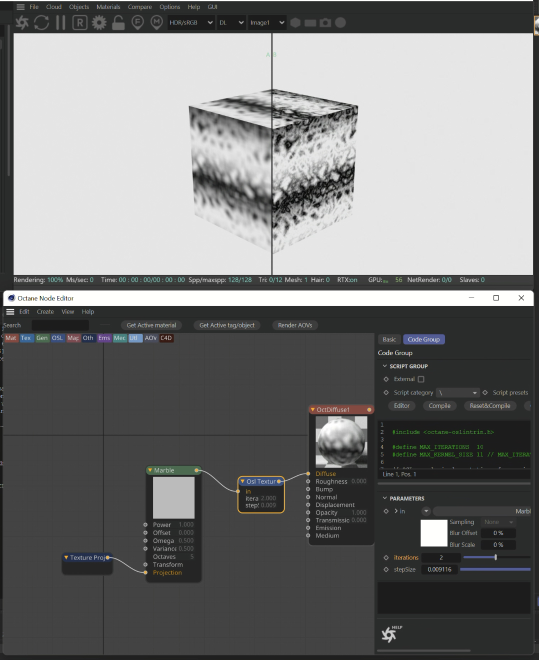

Hi, is there other way to blur noise node than using Baking Texture with low resolution ? I see that there is OSL Blur node but it completely doesn't work.

Thank you, so this blur node doesn't work with standard built-in Octane noise nodes ( even using Projection pin ) but only with custom OSL's ?
EDIT : ok I know why it didn't work for me even using Delayed OSL Projection. Because I had blur node only for bump pin and not for albedo too. The question is how to use Delayed UV Projection but without OSL node betweeen Noise and Albedo ?
Also this node is crazy slow...

Can you share an example scene + screenshots, the issue is not clear, sorryEDIT : ok I know why it didn't work for me even using Delayed OSL Projection. Because I had blur node only for bump pin and not for albedo too. The question is how to use Delayed UV Projection but without OSL node betweeen Noise and Albedo ?
About speed, try to decrease the Interactions at two: ciao,

I mean this situation where OSL Delayed UV projection works fine for blur node on bump pin but how about others like Albedo ? I tried different OSL nodes here without success.

as you can see from my screenshot, it works correctly in Diffuse/Albedo pin, try to place the gaussianBlur just after the Noise, and before the three Gradient nodes.
About Bump power, try to have the same scale, or it is difficult to compare.
In Box mode the scale is in meters.

Yes but I mean that OSL Blur only for bump and Albedo clear noise only. This not work for one noise node because there is need another OSL node between noise and albedo that will support OSL Delayed Projection.bepeg4d wrote:Hi,
