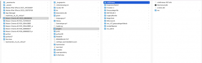

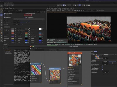

you need OctaneX 2022.1-XB3-R4 native for M1, to be able to work with C4D 2023:
https://render.otoy.com/plugindownloads ... R4_OSX.zip
For C4D 2023, you need to keep the R27.xlib file, and remove both R25 and R26.xlib files.
Note that you need to go to c4doctane Setting/Nodes, and disable the New style option, or material preview doesn't work in node editor:

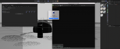

Hi Beppe,
I tried your link/directions above, but continue to get this error message:
There is no CUDA device which is selected...
Tried every combination of selecting the devices in Devices/Available devices settings, but always get the same error message.
Mac Pro (2019)
Processor 3.2 GHz 16-Core Intel Xeon W
Monterey 12.6.1
GPU: AMD Radeon Pro Vega II Duo 32 GB
Using the plugin in the link you provided (c4dOctane-R27.xlib), I tried to get this to work on C4D 2023.1.2, and then updated it to 2023.1.3
Also, i tried using (c4dOctane-R26.xlib) in the link you provided, with C4D R26.015, but i get the same problem.
Do you know what could be the problem, and how i can fix this?
Screengrabs attached.
Thank you,
-Dean
Posts: 10634
Hi Dean,
sorry, the linked version is outdated, now we are at 2022.1-R3:
https://render.otoy.com/customerdownloa ... OSX_m1.zip
But please consider that new versions are working only on Mac with Apple Silicon M1/M2 GPU.
Since your Mac is equipped with AMD GPU, you need to go back to C4D-OctaneX PR14 in C4D R26:
https://render.otoy.com/customerdownloa ... o_PR14.zip
For C4D S26, you need to keep the R25.xdlib file, and remove the other .xdlib unused files.
