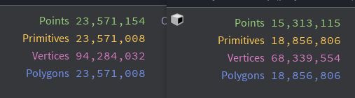

I've been trying like heck to replicate this issue outside my main file with no success. Is there a deeper program level I can access through Houdini or Octane to troubleshoot what is happening?
In general what is an "Unexpected Primitive Type" ? Just a bad geometric shape that sometimes Octane renders and sometimes not?
Overall it still seems to be related to velocity multiplication I'm using like below to control motion blur. Which works in my example file but not in my project file.

Hmm, if you have 23M points or polygons in a single object, you can indeed be reaching some kind of Octane core limitation, although it can depend on the other attributes that you have in the object, like UV maps, vertex attributes, or as you say the "v" velocity attribute.
You could try to import half of this object into an additional OBJ node to check if it helps.
