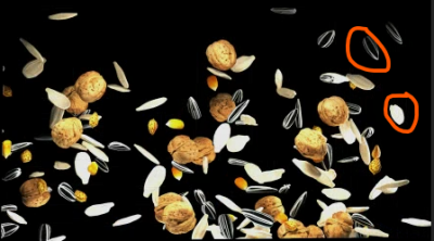

Please see the attached screenshots of the seeds and nuts – the geometry assigned to a particular particle randomly changes. This is happening on a local machine render with 1 3080 Ti.
different particles circled, its happening elsewhere in the render though to different particles.

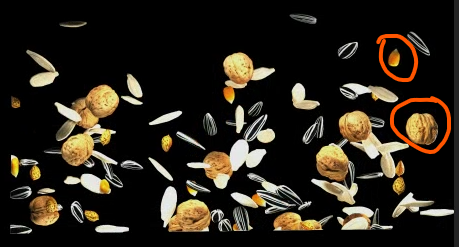

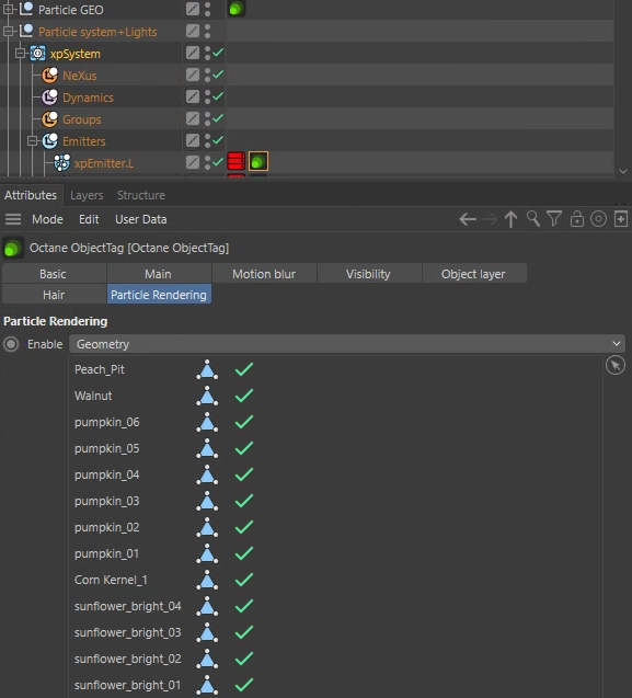

Octane tag
Is there a magical checkbox that I am missing to stop this happening? There are no groups set up, all the geo used is editable objects.

The xpKill modifier was the problem. It must reassign the particle id when a particle is killed which is a bit crap. Seems like an XP problem rather than octane though?
Posts: 16066
Location: Türkiye
pacey84_1 wrote:The xpKill modifier was the problem. It must reassign the particle id when a particle is killed which is a bit crap. Seems like an XP problem rather than octane though?
Better to do some testing with default renderers and give feedback please! Also don't forget to attach a sample scene.
