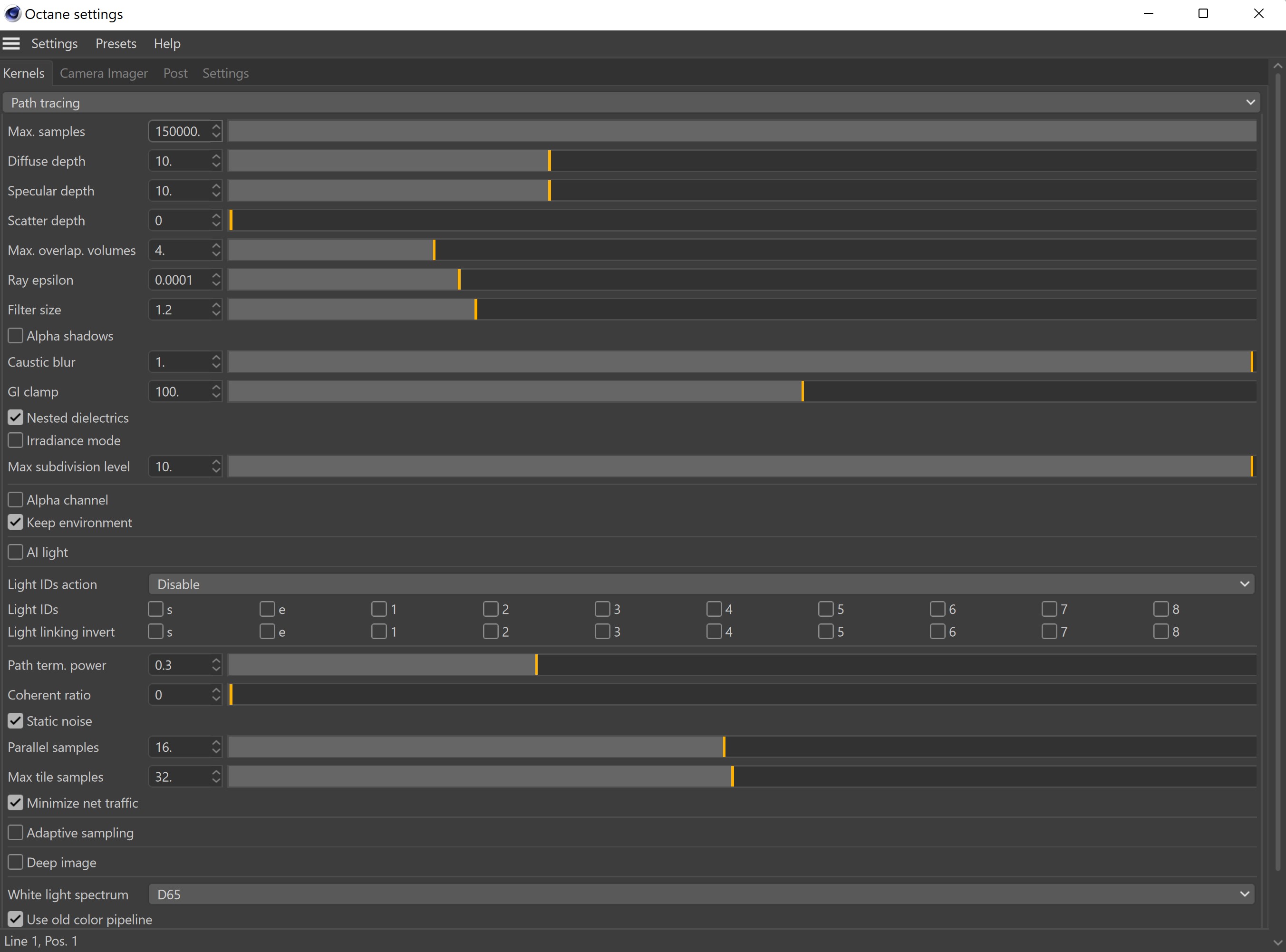

octane settings screenshot attached

don't use hot pixel removal. It's like blurring something and gives flickers if there are much fire-flys. Better to play with specular intensity in materials and keep gi_clamp low as much as possible. And use adaptive sampling to let the renderer may concentrate for this areas.

aoktar wrote:don't use hot pixel removal. It's like blurring something and gives flickers if there are much fire-flys. Better to play with specular intensity in materials and keep gi_clamp low as much as possible. And use adaptive sampling to let the renderer may concentrate for this areas.
I was just showing that I tried it to see if it would render out different results.
Setting the GI clamp to anything lower than 1000 gives off unrealstic lighting in this scenario. I'll give adaptive sampling a go and see how that goes!

I just read that, nothing really new + doesn't solve the problem. Putting the GI clamp below 1000 ends up giving off an unrealistic look, adjusting the specular intensity makes the material look flat,
I'll try adaptative sampling and see how that goes! Thanks.
