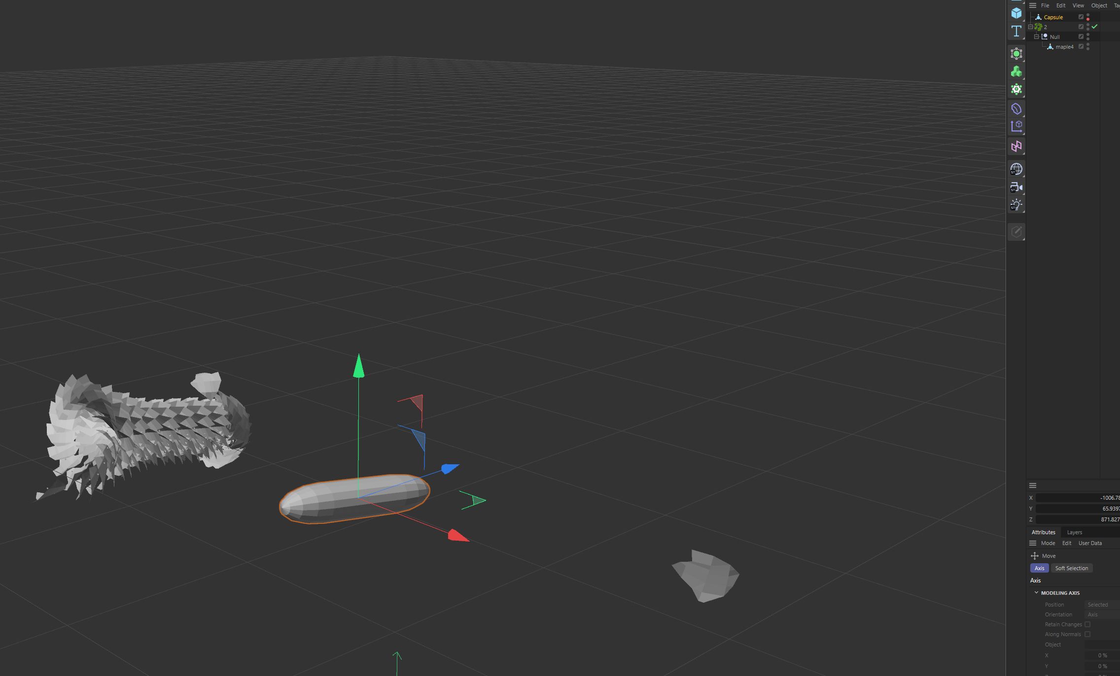

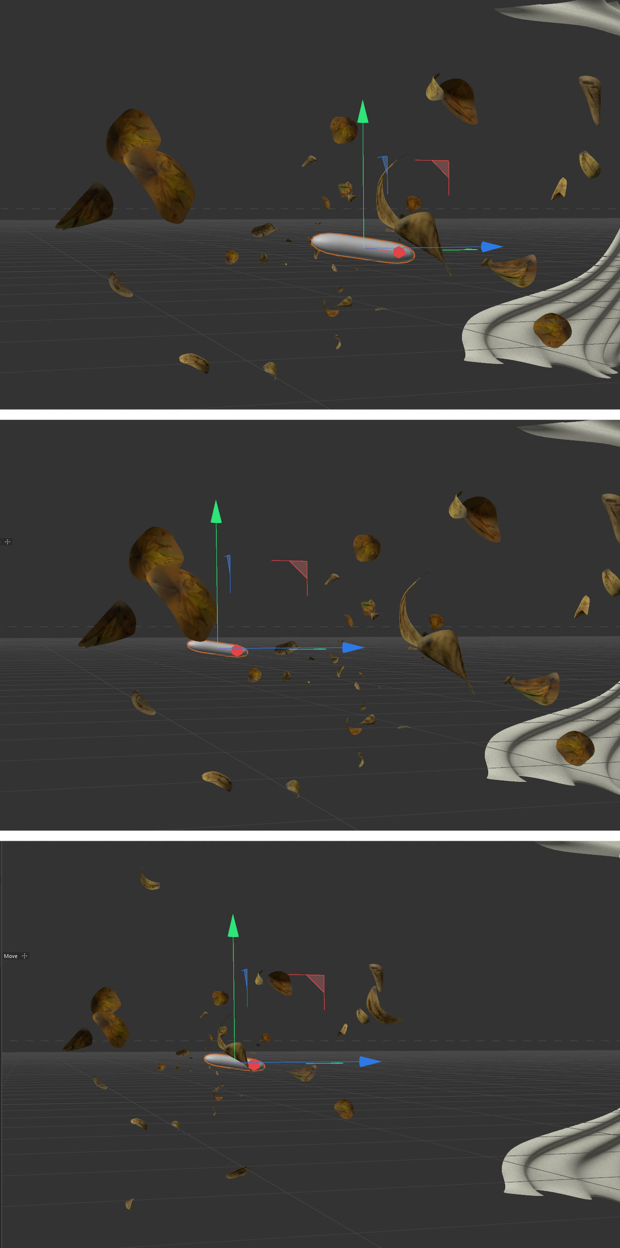

Anyway, here's a few screenshots of my issue. I'm using the capsule as a control object for the leaves, i.e. the leaves are scattered onto the capsule with position and rotation modifiers. When I move the capsule, the leaves stay put. When I turn Scatter off and back on again, it updates to the new position.

There's nothing wrong here, it will not work like this. It will reset the Matrix to distribute over the points. Do how I set it up and will work as putting it under a null.
