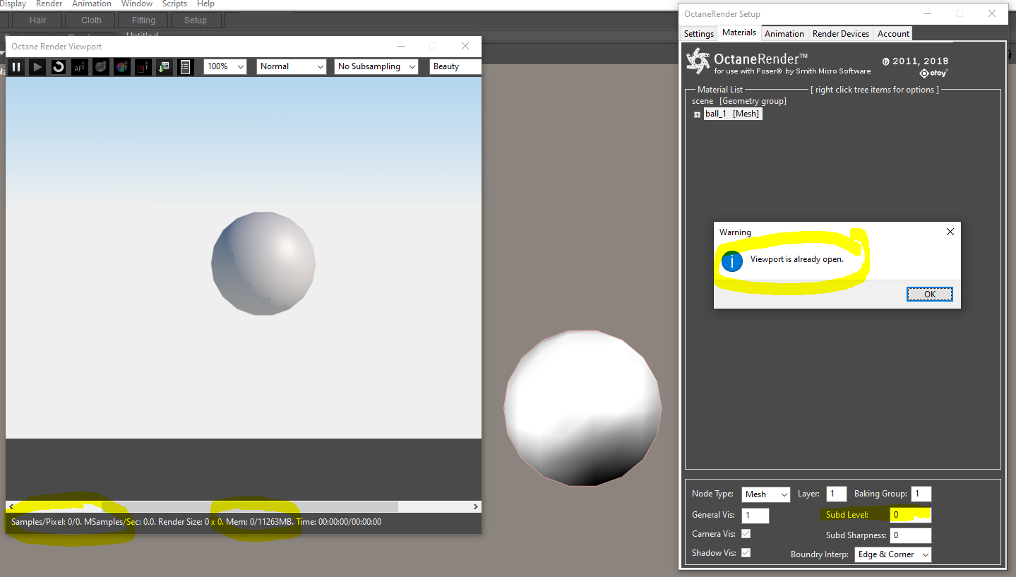

I think there could be something wrong with the subdivision (SD).
I have loaded the Poser "ball" into the scene.
I then changed the "Subdivision" from 0 to whatever 1 or 2 or even 3 and it automatically opens the Viewport (VP) and stats the rendering process (w/o me hitting "Open Viewport")
But the SD level stayed (or changed back) at "0"
With the already open VP, changing the SD level again, the plugin tells me, that the VP is already open, but it does not start the rendering (samples/pixel stay at 0/0), SD changes back to "0" (attachment).

Erick wrote:Thanks for the update. :D
Thanks Erick - I will fix this in the next release.

Erick
Posts: 249
Joined: Thu Sep 13, 2012 9:40 am
@Paul, could you have a look again, on the SD issue reported earlier in here, please?
I think it's still a bit wonky.
Looks like, as if the set SD level ins't "sticking" or isn't applied.
Changing the SD level, with the opened (and paused) Viewport, brings up the "Viewport is already open" message.
Using 2022.1.0.119 Studio+
Thank you.

Erick wrote:@Paul, could you have a look again, on the SD issue reported earlier in here, please?
Thank you.
You need to refresh the Viewport when changing the SD value (as per the tooltip). I will check the "Viewport is already open" message.

I have updated the installers at the top of this thread with:
2022.1.1.120
- Compiled with Octane 2022.1.1
- Fixed python exception when selecting the Planetary Environment
- The "Sun Light" now sets the Sun Direction of the Planetary Environment
- Tweaked the UI for the Mesh node Layer, Baking Group, Subd Level and SubD Sharpness so the cursor does not get 'stuck' in these edit boxes. The later 2 edit boxes need a Viewport Refresh after changing thier values
- Fixed the popping of the "Viewport already open" message
