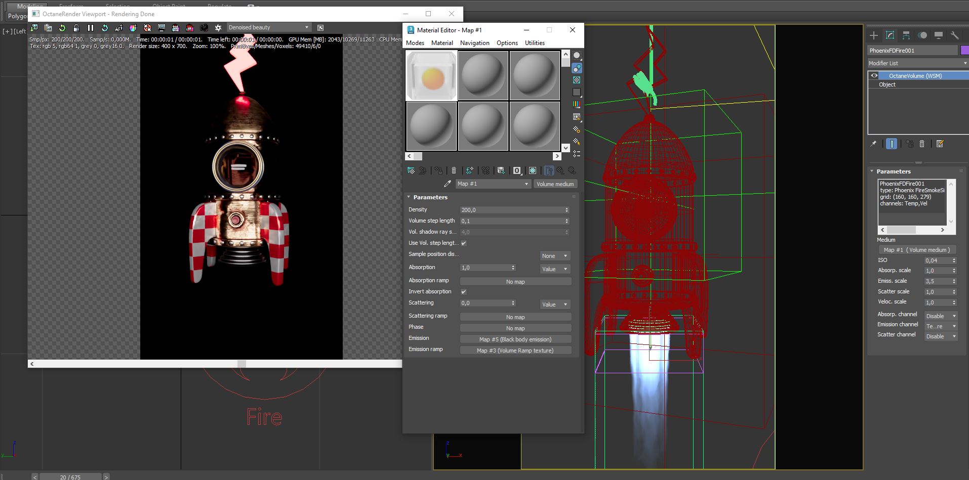

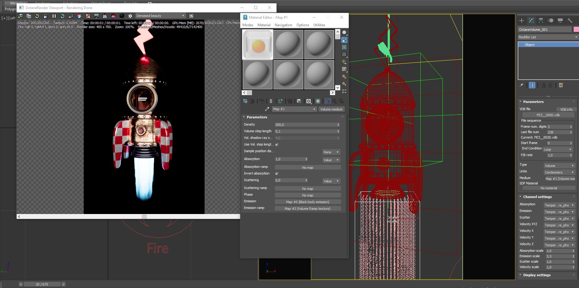

Hello,
I'm using Phoenix fd for a jet engine simulation and when I try to render nothing is showing up... I have to use an Octane Volume to make it render (with the same volume medium/settings), please see attached files.
Is that a bug ?
Thank you in advance !

Hi remKa,remKa wrote:Hello,
Is that a bug ?
We are unable to test for the moment, but it should work / used to work.
Make sure you channel settings match Phoenix FD channel names, and double check the other settings.
The emission channel seems to be set to 'Temperature' .. should it be 'Temp', as displayed in the information box ?
(the correct available channel names should be available in the combo box, but it may change with the timeline.. make sure you set the channel at the frame that it is available)
If all seems fine, you could also try a previous version of the Octane plugin...
Here is a scene that used to work: We'll check with current version as soon as possible.
