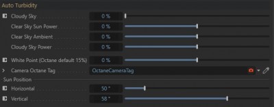

Main idea was to make automated transition from clear sky to cloudy ambient lighting without changing other parameters than Turbidity. Fully working script with user interface will be ready within days. Small preview how it works :
Auto Hosek&Wilkie lighting by turbidity

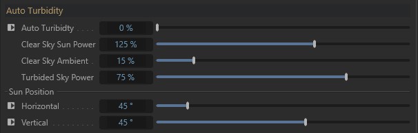

In attachment first version.

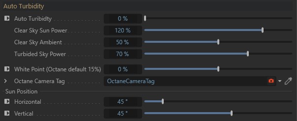

Final version. Added Turbided Sky destination power and Sun position so every important parameters are on the same tab.

Updated version with White Point temperature correction slider.
Please take in mind that Octane default white point is set to 15% because I think that by default it is little to warm. My default 0% was measured on 75% white wall material and Sun at 45degree to be exactly white without yellowish Sun color cast.
This version needs to select proper Octane Camera Tag ( not Camera Object ) to make color correction works.

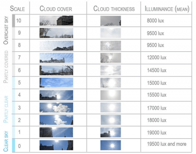

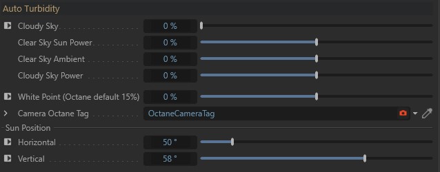

Final new revised version.
Sky lighting was done from one of the best HDR's from PG Skies
Clear Sky - is 1216_v5.hdr ( https://www.pg-skies.net/products/1216 )
Cloudy Sky is - 1927_v5.hdr ( https://www.pg-skies.net/products/1927 )
Cloudy Sky Parameter at 0% is exactly simulation of clear sky HDR map and Cloudy Sky parameter at 80% is exactly simulation of Cloudy HDR map.
New version has all parameters at 0% by default to make them as real as possible to simulate these HDR lighting.
You can change "Cloudy Sky" percentage and all other parameters will simultaneously ( internally ) change too including sky color cast shading, Sun intensity, Sun shadow fallow and more.
