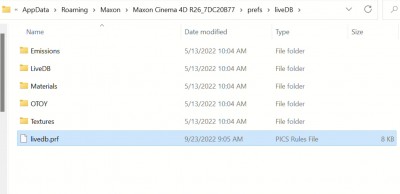

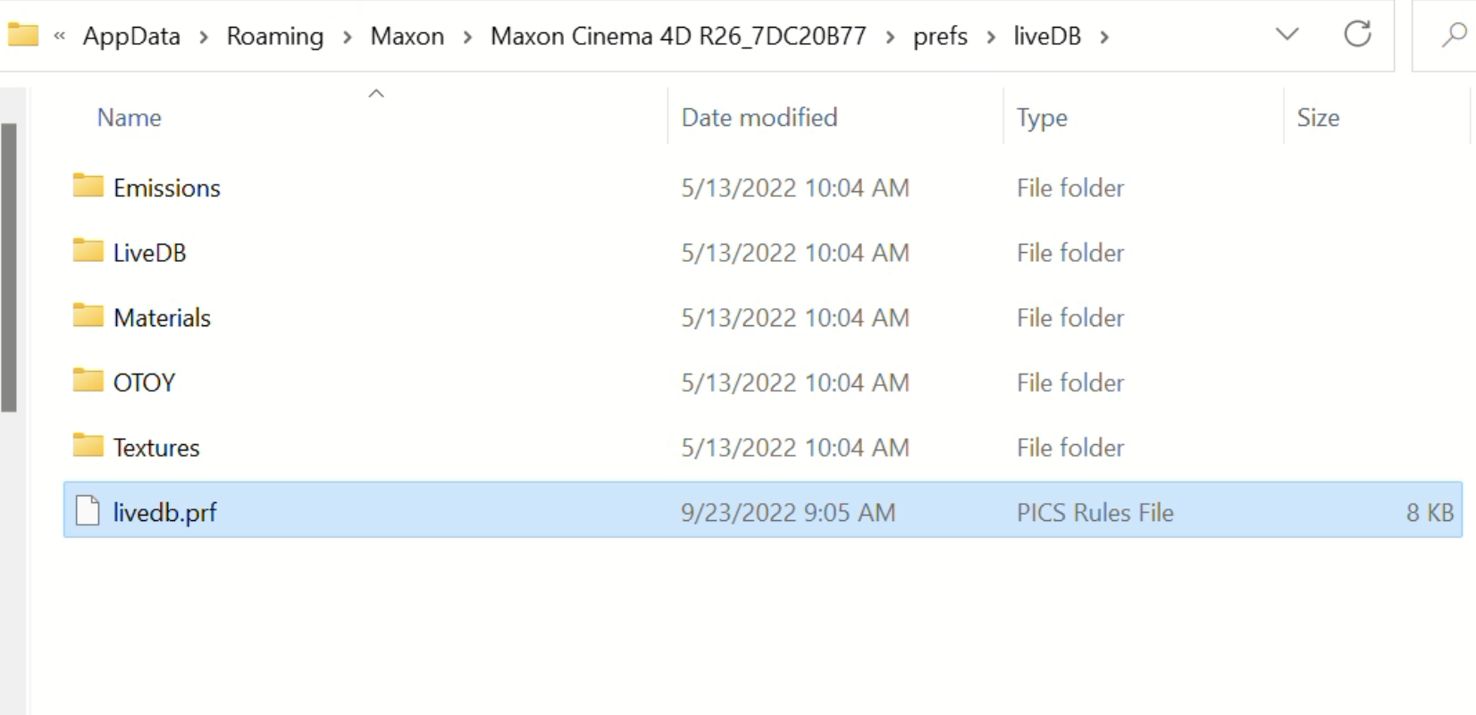

NZ team should have found a solution:
Please try to delete the livedb.prf file from the path C:\Users\YourUserName\AppData\Roaming\Maxon\Maxon Cinema 4D R2X_XXXXXXX\prefs\liveDB\.
Looking forward for your feedback,
ciao,
Beppe
