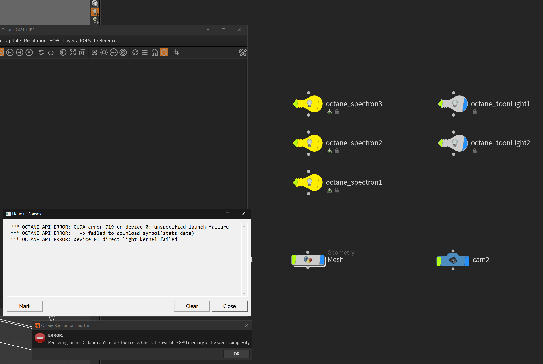

I'm trying to render a toon material and the moment I tried adding two toon lights I got an error, sometimes it even says I don't have enough memory (with a basically empty scene)
Running W10, H19.5.403 RTX3090 drivers 526.98
File Scene: https://www.dropbox.com/t/lofSbV1HIU6z4mv7
PD: just tried in 2022.1 version of the plugin and is the same error.

Terryvfx wrote:I'm trying to render a toon material and the moment I tried adding two toon lights I got an error, sometimes it even says I don't have enough memory (with a basically empty scene)
The problem comes from the material layer node. If you remove it the rendering seems fine. Perhaps this feature is not compatible with the toon shading, but anyway this is a core issue. I'll report it to the core devs.
-Juanjo
