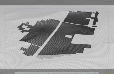

Hey Juanjo,
thanks for the prompt help! I have NDAs in place, so I can't really share the scene, but here's a screenshot for an overview. I can replace the actual products with boxes though, if it helps.
This is a huge solar farm array with thousands of separate trackers. I'm using a chain SOP to connect them as we have to animate the underlying terrain and the array has to conform to these changes. Obviously, I have to pack the geo before the chain SOP or else it'll distort.
I'd need a way to export a static setup with only a camera moving to render on RNDR, but it seems I'm stuck at exporting to ORBX (even though the array is static, doesn't need to update), works fine on my workstation. Tried copy to points as instances but didn't really came out nicely.
Let me know if you have any ideas
Thanks,
Chris.
Thanks,
Chris.
