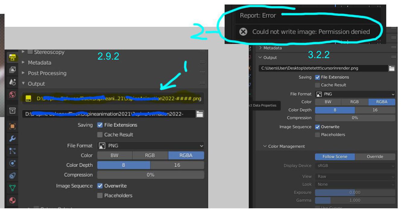

ADDED INFO: sorry to pile on, but maybe these things are related. Render will not save in the file 3x fail scene.blend. This is the file that does match Render and Preview. One frame of a two frame animation will show, but not save automatically, nor manually (alt S) . In addition, very strange - an image of the cursor is present in the rendered image.
Also, Maybe relevant, in the comparison image of the output settings, there is a missing data line in 3.2.2. Maybe it moved? See Screenshot.jpg, yellow highlight.
Additionally: for the file, mismatch P and R, if you start a 2 frame animaion at frame 259, again, saving is denied.

Neither of the uploaded files here are able to render past the first frame, nor do they allow image saving.
Starting a new file from scratch gives no relief.
Switching from Octane to Evee, or Cycles, no relief.
The Server and Blender are within a subfolder in Windows Programs.
I am running the latest Nvidia driver.

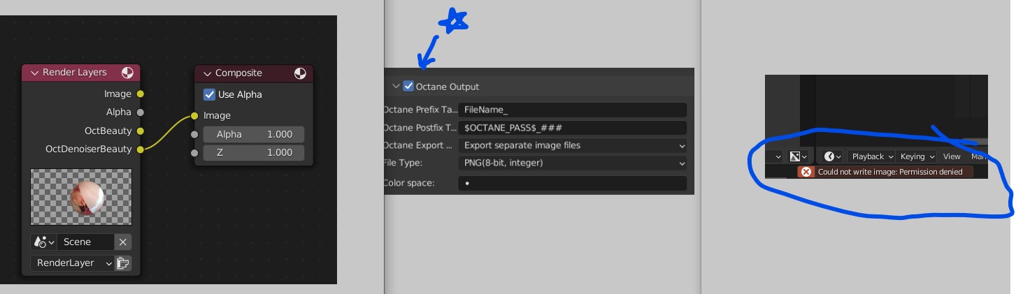

Both Beauty pass and Octane output are disabled in the scene, that´s why you can't get any render saved to disk.

The image below shows my setup in 3.3. and also in 2.9 , except for the starred item.
2.9 did not require this enablement for Octane Output, at least where I have found it within the scene/output tab for both versions.
Does it exist somewhere else?
As I have it, enabled or not, still saving is denied.
I am missing something obvious, and I apologize, but could you direct me to the Octane Output you are referring to?
Thank you

Hi!
The panel is the same one you show in your post.
The problem you have seems to be related to some permission on your system.
Did you try launching both Server and Blender as administrator?
