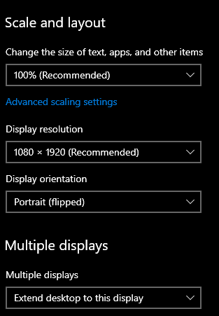

Do you have Poser->General Preferences->Interface->Interface Scale Factor set to 1?
Also, what are you Windows->Settings->Display->Scale and Layout settings please?
Paul

face_off wrote:Do you have Poser->General Preferences->Interface->Interface Scale Factor set to 1?
Paul
yes, My Interface Scale Factor is set to 1.
And I uploaded screen shots

Thanks. I could not replicate the problem. I thought perhaps the python UI widgets were on top of each other a little due to your screen scaling, but that appears to not be the issue. Perhaps if you can provide some screenshots showing the problem I can investigate further.
