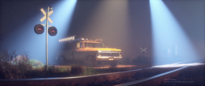

For a customer project i need to recreate a simple spotlight like on a stage (image 1).

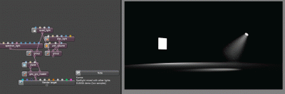

If i use the standard spotlight without any other lights, it works great (image 2).

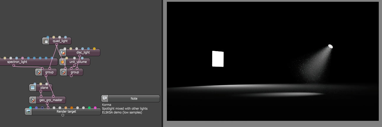

But the moment i add more lights than just the spotlight, the whole system fails (image 3).
