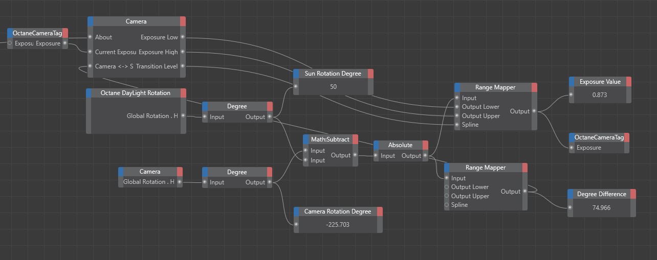

If someone is interested I made simple Cinema 4D XPresso for simulate real camera exposure where exposure is higher when we look directly on bigger object which is mainly in shadow ( Sun in front of us ) and exposure goes lower if we look on very bright object and Sun is behind us.
Exposure is set from 0.5 if Sun is behind camera to 2 if Sun is in front of camera.
Exposure strenght transition can be edited in Range Mapper spline.

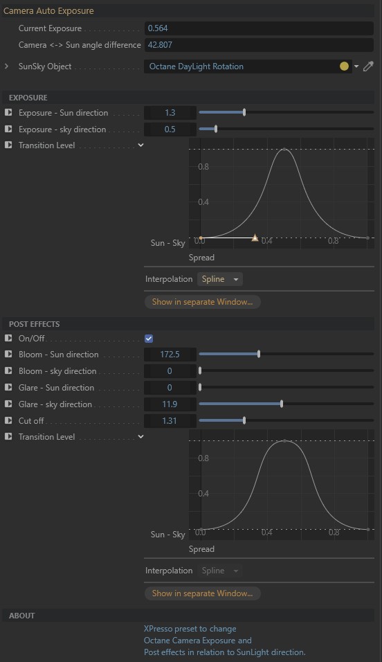

EDIT : Updated XPresso script with user interface :
Added actual exposure information, camera to sun angle difference ( which help to set proper exposures for 0 and 180 degrees ) and input to choose Sky object.
New version : added Post Effects - they works the same way - changes strenght in relation to Sun direction.
