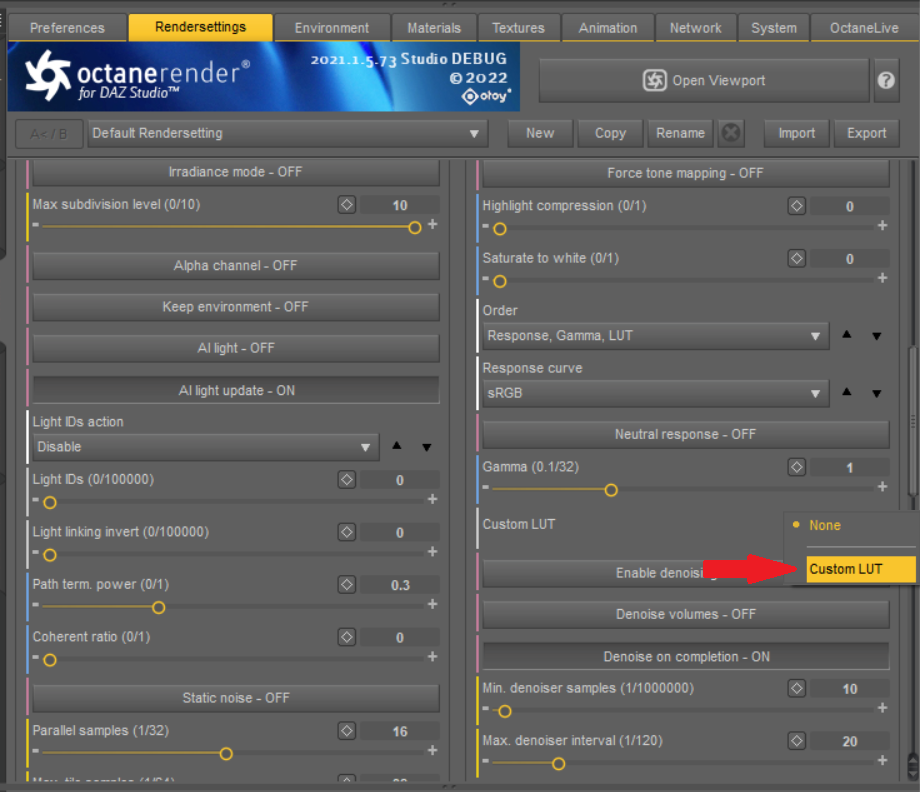

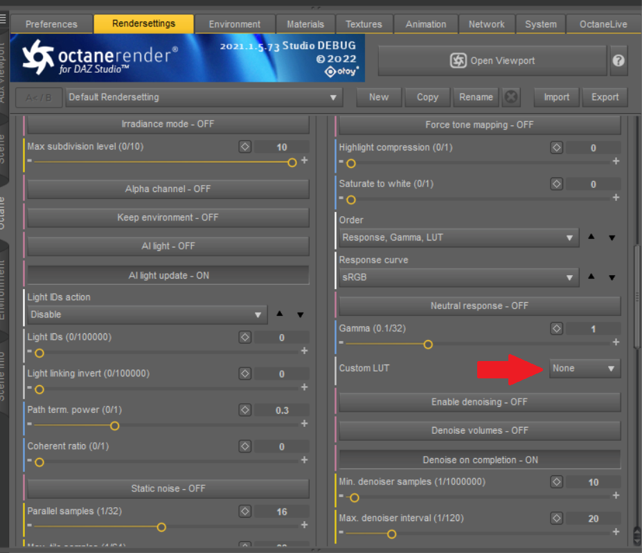

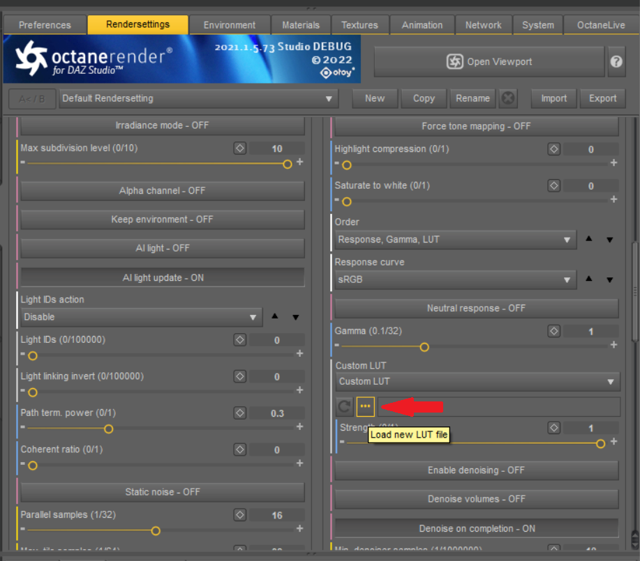

  • Custom LUTs
    Under Rendersettings, you can now create a "Custom LUT" node and load a LUT file.
    You can get example LUT files from https://www.rocketstock.com/free-after- ... ng-videos/ and many other places.

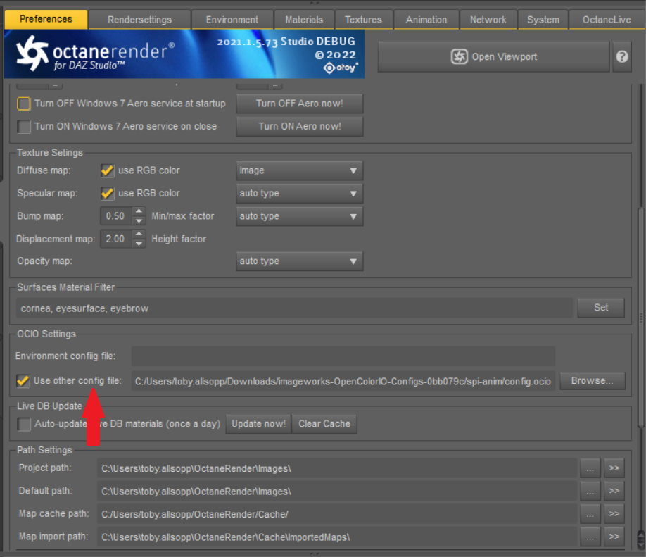

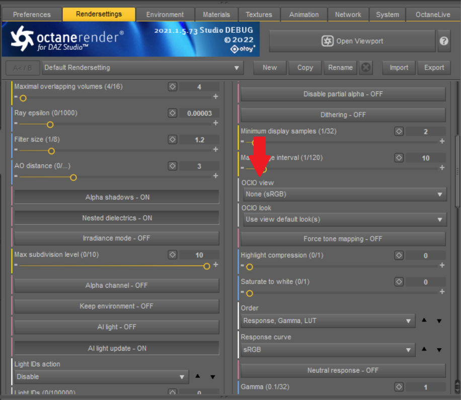

  • OCIO
    • Download the latest ACES OCIO configs from https://github.com/colour-science/OpenC ... s/tag/v1.2
    • Load an OCIO config file, either by setting the OCIO environment variable before starting Daz or using the new preferences:
    • Choose the view and look to use in the Rendersettings:

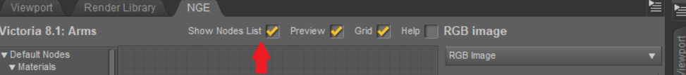

  • Sticky Node List
    If you don't like the list of nodes you can drag from disappearing all the time, there is now a checkbox to make it stay put!

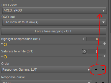

Sorry I forgot to attach the image. Yes, the up and down arrow like shown in the image. If we can get that added to the end to scroll through available options from the list.
OCIO scroll option
OCIO scroll option
toby_a
Posts: 261
Joined: Tue May 10, 2022 11:59 pm
Tugpsx wrote:Sorry I forgot to attach the image. Yes, the up and down arrow like shown in the image. If we can get that added to the end to scroll through available options from the list.
Right, I see. Shouldn't be a problem.

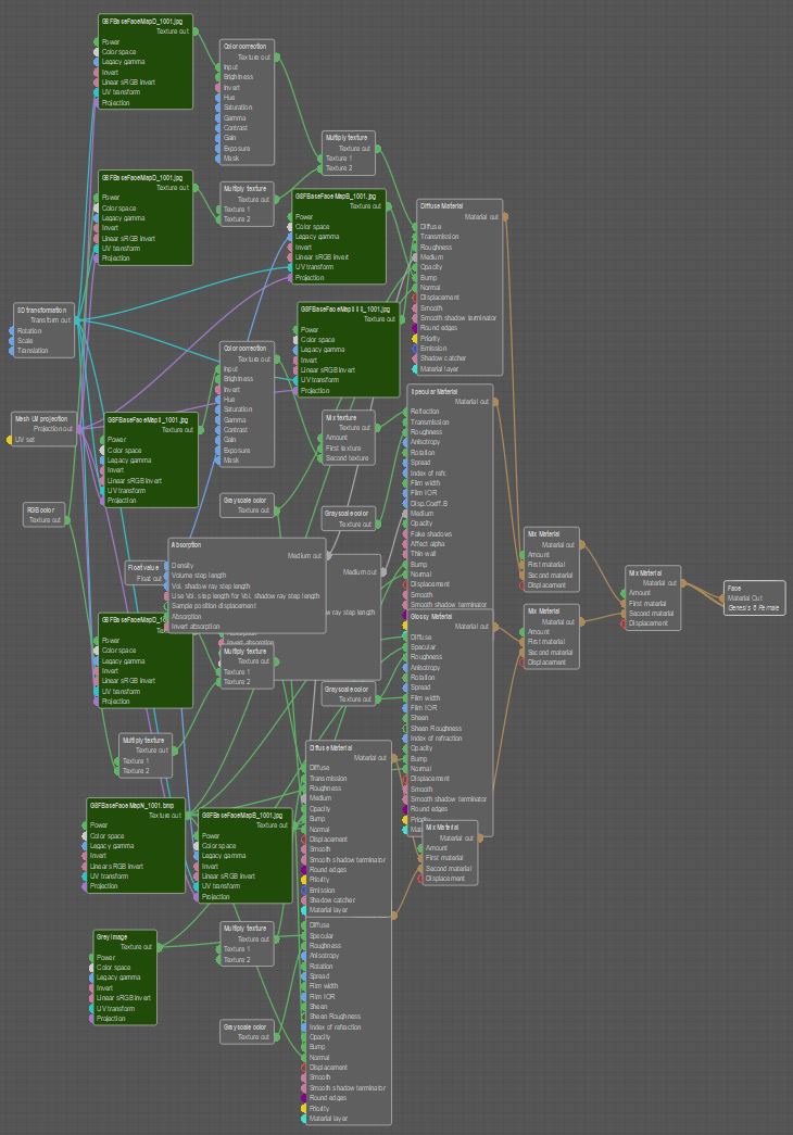

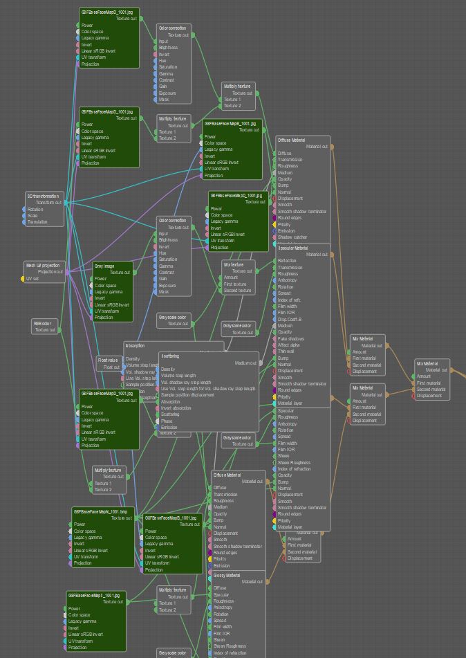

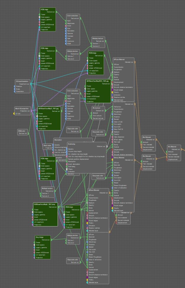

Hello,

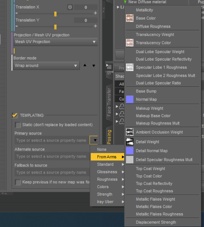

I've been playing with the new template configuration and as for setting it up, it is great. I haven't tested the manual entry yet, but the menus and selections, when the material is connected or not to a surface, are nicely done. Thanks.
As for applying the templates, there are still some inconsistencies.
Here is my setup. I tested with a base Gen8 character face but I checked and the behavior is the same with any material.
I have a template material derived from the Redspec materials, on which I set up the new templates. I have set Translucency on transmission, Diffuse, Bump, Normals left unchanged from the original material, with modified parameters, and the Specular map is used twice. The first use is for general reflectivity, and the second one is to emphasize wetness a bit. I set a default map for the normal with the "Keep previous" checkbox active because the base Gen8 material does not have normals. The default normal map was created from the Gen8 bump map with "Materialize". I start applying the template with a blank material attached to the surface.
1. The "default" maps are still not applied, even if they are declared as templates (diffuse, opacity, bump, normal). Fixing this could be a good way to make things close to what DAZ users are used to when appying materials.
2. The behavior of the template application is not constant.
  • When I apply the template from the presets, I have the Transmission/Translucency map applied, and only one of the Specular maps, but not both. None of the diffuse, opacity, bump maps are applied. The normal map remains the default and is not unset. (see attachment Face_from_preset.JPG)
  • I reapply the blank material, then the template material from the unused materials, and then all the maps are applied, except the Specular map that was previously applied. (see attachment Face_from_unused_1.JPG)
  • I reapply the blank material, then the template material from the unused materials, and it's like when I applied the material from the presets again.
3. I tried something else then. I applied twice the material from the preset, making a copy in the unused materials, and I cycled applying both template materials instead of switching back to the blank. I get a cycle between no base maps applied and all base maps applied, with either one of the two specular maps applied, cycling too. (Face_from_unused_2.JPG and Face_from_unused_3.JPG)
4. I tried reapplying the DAZ materials, leaving the template Octane materials connected, and we are back to square one.
I will keep doing tests. If you could fix the initial loading and the issue with multiple maps with the same reference from DAZ shaders, I think that it would become possible to package a material set that could be applied over a DAZ material without further modification.
