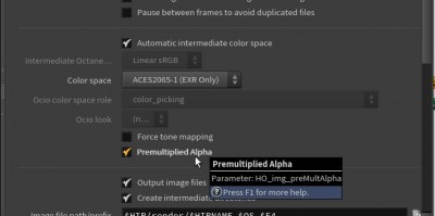

I do not find the alpha premultiply option (before it was in the image tab).
Octane 2022.1 XB 2

Now it is part of the render options in the Octane ROP node, but I think that this feature is broken in the XB2 plugin build. It will be fixed in the upcoming XB3 version.
Thanks,
-Juanjo
