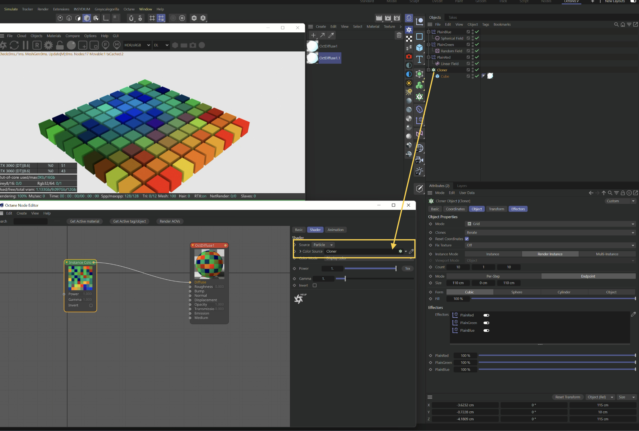

you cn use the Fields to control three different effectors, one per RGB color, then use the Octane Instance Color node, in Particles mode, and use the MoGraph Cloner in Render Instance mode as a source:

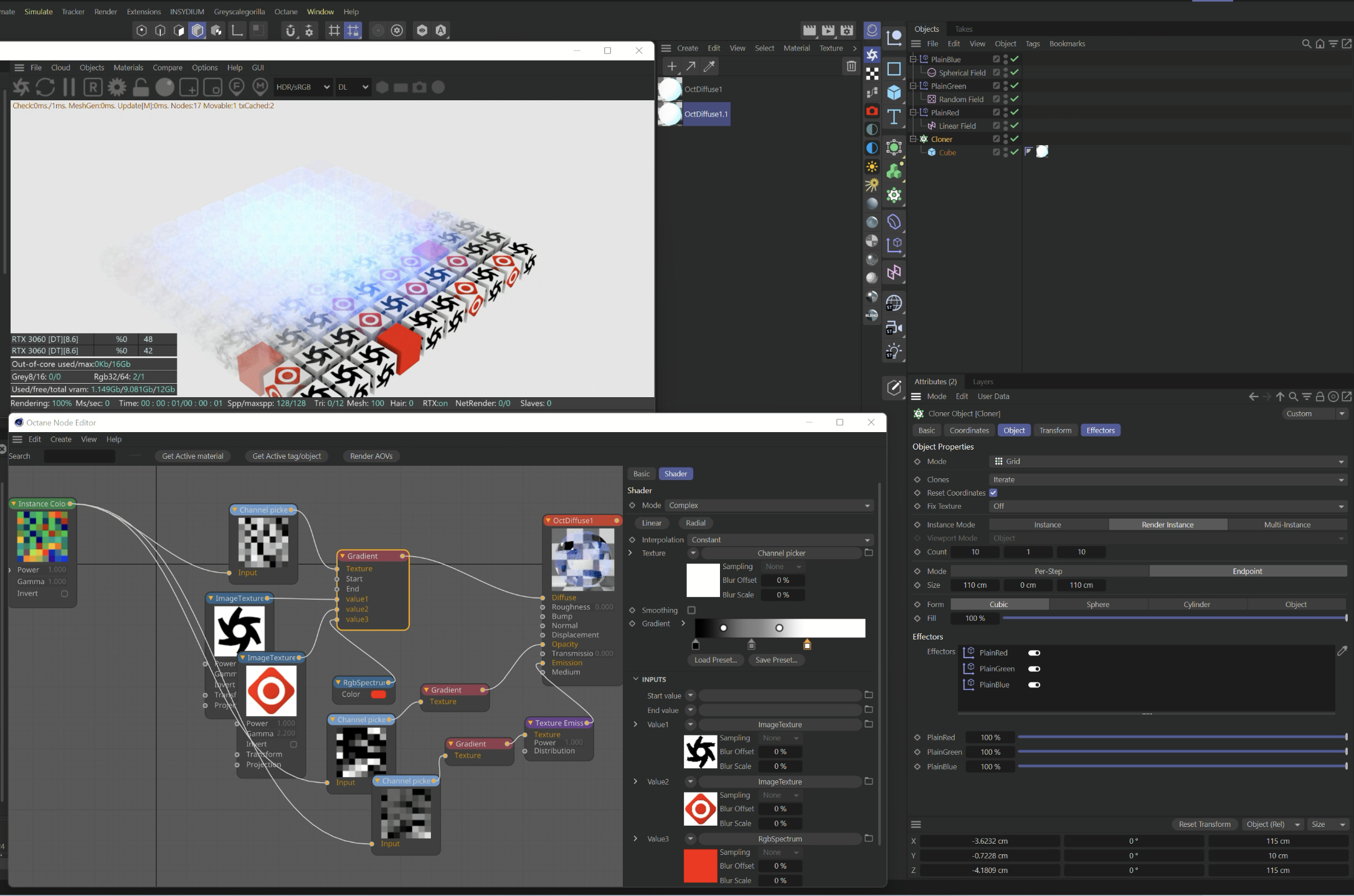

Then you can use the Channel Picker node to separate the three RGB channels, and use them to control different channels, in this example I have used the Green channel to control an Octane Gradient node in Complex mode (similar to Multi Shader), the Red channel to control Opacity, and the Blue channel to control Emission:
