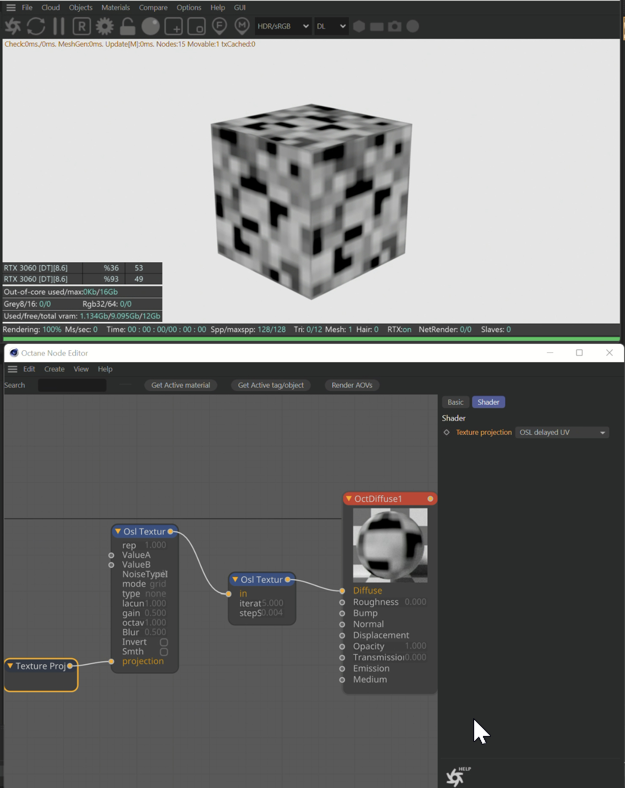

you need to have a Projection pin in the OSL shader, in this way you can add a Projection node to it, and set it to "OSL delayed UV" mode, to enable the Gaussian Blur OSL node:

Yes, the OSL node must have the Projection pin in the code.

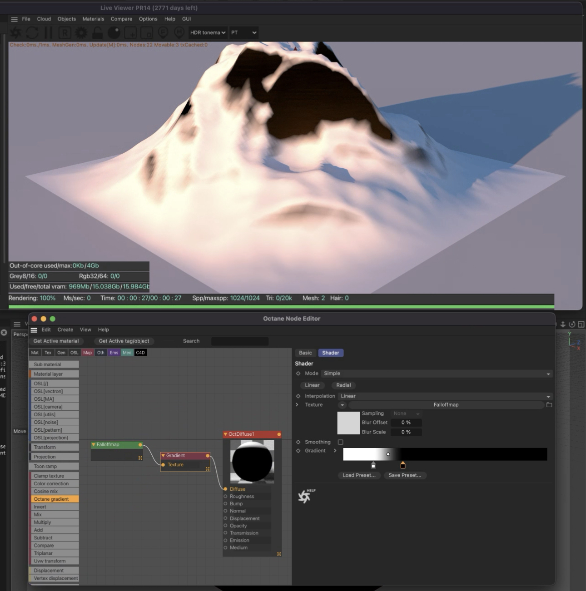

I had a look at the OSL shader, but since it involves geometry, it cannot work with gaussian-blur.osl node, even with correct projection.

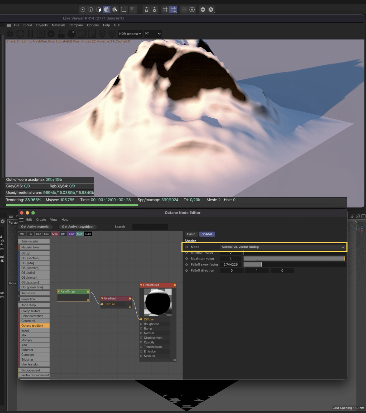

Anyway, you can obtain the same effect by using an Octane Falloff node in Normal vs vector 90deg mode:
And use an Octane Gradient to define the blurriness you want:
