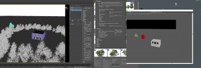

Hey
why ist not working the FP?
neonZorglub
Posts: 1103
samsue wrote:Hey
Hi samsue,
See the WARNING message in the FP support tab :
It means that the FP object is set to use 'automatic' render mode, that will generate instances of meshes, but that is not supported when octane is set to 'standard' support.
The 2 buttons after the WARNING message will fix this with one of the 2 solutions:
-'Oct:Direct' (recommended) : will change the support mode to 'direct' mode.
That will use instances, so use less memory / cpu ..
-'FP:meshes' : will change the FP object to use 'mesh' .
That will generate a big mesh for all FP objects. that will work with 'standard' support.
