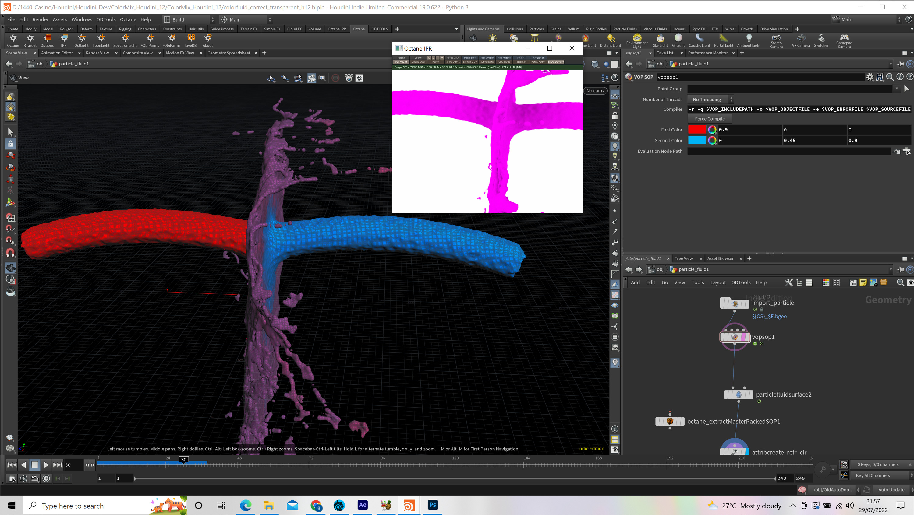

I'm a newbie to Houdini I've been following a tutorial on two fluid streams hitting each other I can add a single color using the octane materials but how do I add two separate octane materials like in the viewport, any ideas would be much appreciated. Thanks :)

Here you go. I've attached a file.
Basically what you wanna do is pass the Cd attribute to the shader and use that to do whatever you need, color it, mix materials, etc...
It's explained here how to do it https://youtu.be/f4xNxOd1I0U
