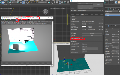

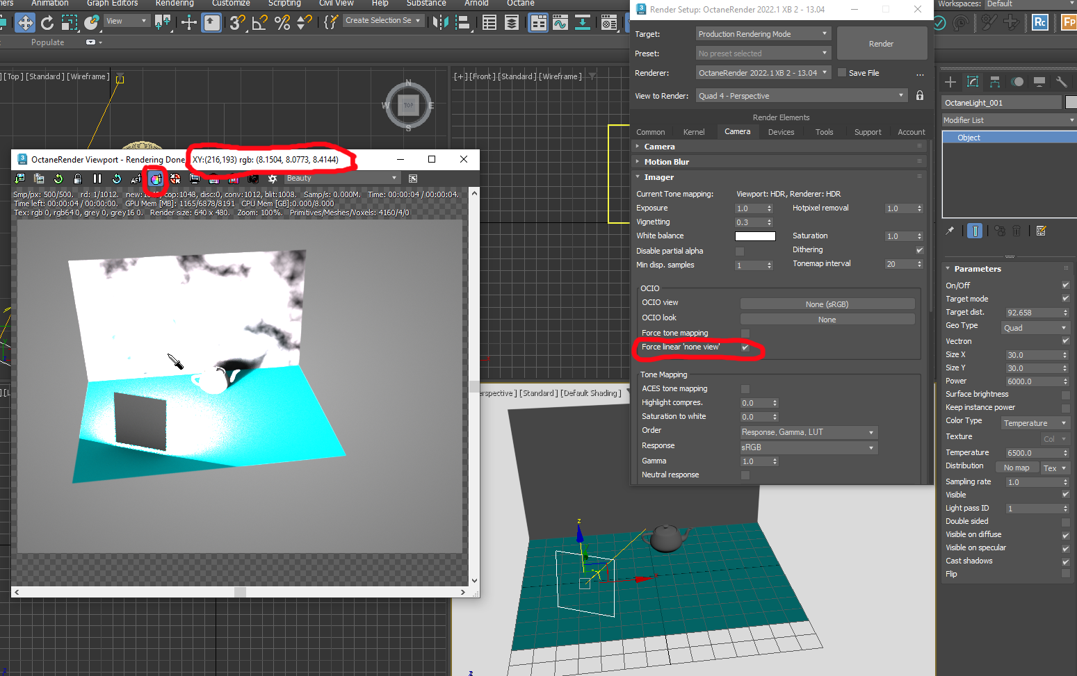

Pixel Color display, linear workflow, EXR
(From version 2021.1.5 - 12.22 / 2022.1 XB2 - 13.04)
The White balance picker can display the current pixel color in the viewport title bar.
This is updated while moving the mouse.
If you unintentionally click and change the white balance color, you can undo the change in the 3dsmax Edit menu.
When using LDR, the values will be integers in the range [0, 255].
When using HDR, the values will be floats in the range [0.0, 1.0], or unclamped values with a linear setting.

Alternatively, you can set OCIO view to 'none' and enable "Force linear 'none view'"
When saving as 3dsmax EXR with linear workflow, be aware that the '3ds Max gamma hack' should be disable, or else the 3dsmax gamma value will be used on the image.
When saving as Octane EXR, no gamma hack is used; the image is not using 3dsmax gamma.
The color displayed with the White balance picker also don't use the 3dsmax gamma.
